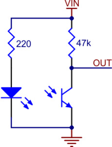

So, I'm trying to build a unit with twelve infrared sensors using radioshack paired emitters and phototransmitters.  I have a arduino that will be reading on/off from the pins and then generating a midi signal up to a controller.
To prototype I built the following two circuits
  5V ----- /\/\/\/ ---- emitter ---- LED ---- Gnd  (LED stays on so we're getting power)
  5V ---- /\/\/\/ -- photransister --- LED --- Gnd  (LED never comes on)
The emitter is rated to 5V 150ma and I'm in spec.  I did have two of them where the smoke came out as I miswired this very easy circuit.
HELP! What on earth am I doing wrong?  It's driving me screwy.

Try it with the phototransistor connected to an arduino input pin.  Take the LED out of the circuit and connect it  up like this:
  5V ---- /\/\/\/ -- wire to Arduino input pin---- phototransister --- Gnd
Run one of the switch test sketch's, the wire to the phototransistor will act like a switch and make the digitalRead  go low and high as IR light level reaches the correct level for the  phototransistor.

Is this the item you're using? http://www.radioshack.com/product/index.jsp?productId=2049723&cp=&sr=1&origkw=ir+emitter&kw=ir+emitter&parentPage=search
It says the emitter is 2V, 40mA.   Assuming about 2V for your LED, you have 1 volt dropped across the resistor, which means you have 3.6mA through the LEDs (using ohm's law and kirchoff's current law).  I would imagine the visible LED is fairly dim, and the IR LED is even dimmer.

Quote
In picture form, you want to wire your emitter/phototransistor circuit something like:
You'll want to tweak the two resistor values to achieve the ideal response curve for your particular emitter-detector pair.

Yes! It worked. Thanks for the advice.
It's very sensitive to ambient light.  I need to tweak my resistors some I guess.
