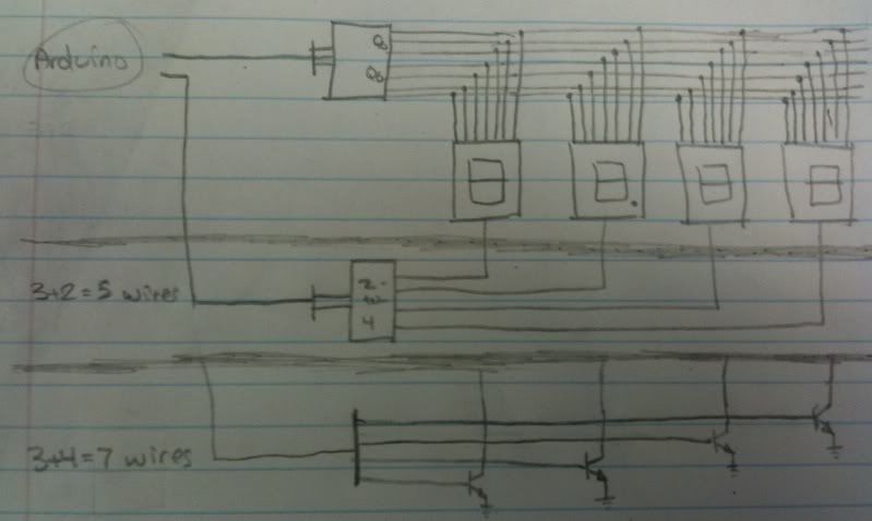

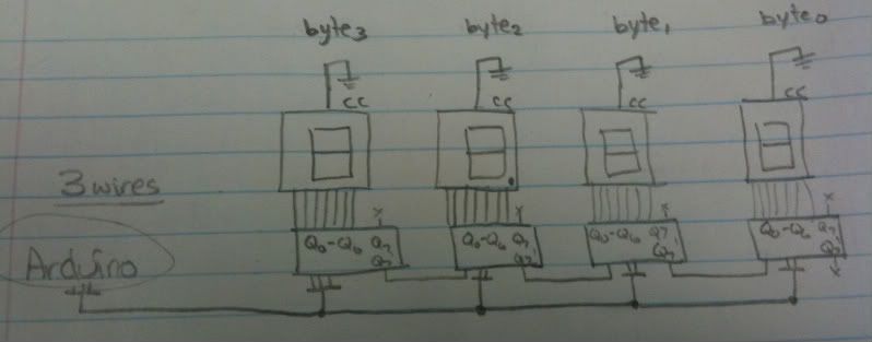

Good, there's been some discussion while I was gone :) While I was in class I drew up some stuff. Here goes:
Table showing segment/Qx association/bin/hex conversion:
Table showing hex value for the numbers 0-9 (tested and working! :))
Idea 1: Connecting the displays with only shift registers (for a total of 3 wires per group of displays):
Idea 2: Connecting the displays with a shift register and either a 2-to-4 line decoder (for multiplexing the displays) which would need five wires, or using a transistor (missing resistors - just a block diagram) for each display, for a total of seven wires per group of displays:
Now, some of these ideas may not even work, I was just trying to come up with ideas, to prove that Im serious about doing this (and not just trying to con you guys into doing my work for me!). So far, Idea 1 with one shift register per display seems the best, as the coding would be the easiest - I expect it would go something like this:

Those are all good ideas. Did you say the two displays on the right were displaying constant degree symbol and the "C"? In that case you could hard wire the characters although you'd have to fiddle with resistance to get the same brightness as your live digits. Probably a little too much "refining" as you might want to use those digits in the future.
Think about the code for the case where you have only one shift register. What do you have to do to maintain a reading in your live displays before the next refresh?
Think about the case where you have a shift register for each live digit. Ask yourself the same question.
What about if you have a chip that turns decodes BCD into 7 segment (4511)? Does that give you more or less time for other processing than the other two cases? Which strategy of multiplexing gives you least time to do other things? Which one affects the quality of the display the most or least if you stop doing it for a moment?
This is starting to sound too much like a homework assignment and it's supposed to be fun! :D

Quote
Yes, there will be two more displays to the right of these four, which will display "°C". I was planning on using a 1k pot and adjusting the brightness to match the others.
Quote
To be honest, I havent even put any thought into this method, other than just 'can it be done'. Being as new as I am to writing code for a uC, Im planning on staying away from multiplexing for now, as that adds another element of unknown to my code, and I already dont know what Im doing as it is ;)
Quote
Unless Im misunderstanding you, wouldnt I just have to not start shifting until I poll the sensor? The shift register is going to keep the digit lit to whatever I have loaded into the latch until I load something else, right?
Quote
Here, let me delve deep into my knowledge of multiplexing... The first kind :) I know the idea behind it (switching displays on and off quickly to trick the mind into thinking theyre on all time), but Ive never seen it implemented in code or looked at the various methods.
Quote
Ive never had a homework assignment like this! :P Mine consisted of "create a circuit that uses a one-shot multivibrator to turn a 50kHz 80% duty cycle square wave into a 50kHz 50% duty cycle square wave." This sounds more like a big term project ;)
EmilyJane
As far as the decoder goes, you have to write the BCD code into the decoder for each displayed digit and then write the cathode for that digit low for your multiplex time. The digital out pins provide the latch function during the "on" time.
I think you will agree that out of the methods you've considered, the one with a shift register for each digit has the lowest overhead in terms of % of available processing time.
Another method would be use one shift register driving two BCD to 7 segment decoders where the shift register contains the two BCD digits instead of segment data. Just a different way, I don't suggest that it is better or worse.
Wow, you've got it easy. :)

Mike's example was using FET inverters as anode drivers which required an active low to enable. OP already has common cathode displays and he is driving the anodes directly from the HC595. Agreed that he could just as easily drive those same anodes with FETs and negative logic from those same shift registers. He would not use 7442s to do that, however.
Maybe the difficulty would come from having to wire up all those extra transistors.
