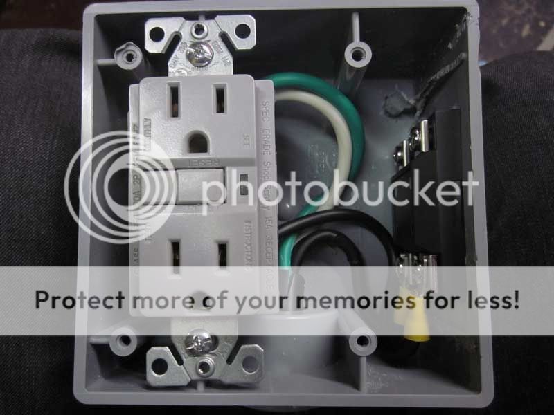

Okay well I've made some good progress and am about ready to hook this all up.  Attached is a picture of the switched outlet box I put together... I took a 12g extension cord and cut off the one end... hooked it up to a 25A SSR and then to a 15A GFCI outlet.  Hard to tell from the pic but there's a CPU heatsink attached to the SSR too.  I've also got another box with the arduino, LCD and jacks for thermometers... will be running one additional +5V/ground to the switch side of the SSR.
Can you have a look at the wiring below and let me know if it looks okay before I go plugging this thing in?

This seems adequate. The black has been cut and wired to the SSR. The GFI is a nice touch. The crimps on the spade lugs look good.
I would suggest a barrier over the 3-30V input when you've installed wires to it. Also use a separate opening for those love voltage wires in case they break and touch AC or the AC wires break and touch them. Dress them away from any AC outside the box.
I think the heatsink is outside the box? If so I believe you should tie that to ground just in case you get a catastrophic failure and one of the AC lines break and touch it or the SSR fails in a way the manufacturer will swear is impossible.
The most common failure I see on industrial controls is a wire breaking and falling where it should never go if dressed and tied down properly.
On commercial and consumer equipment low voltage inputs and outputs; transorbs are commonly found to keep high voltage transients and induced currents out of them.  If you use them use a fuse in series.
http://en.wikipedia.org/wiki/Transient_voltage_suppression_diode
http://www.opencircuits.com/Input_protection
http://forum.allaboutcircuits.com/showthread.php?t=6784
If it was designed by man it can be repaired by man.

Make sure that you have your hot lead and neutral lead connected to the right terminals on your plug; you don't want these to be swapped, because if there is a failure somewhere in the controlled appliance or elsewhere, an electrocution hazard can present itself. It looks like you have things wired OK, but we can't see where the wires go to the terminals on the outlet...

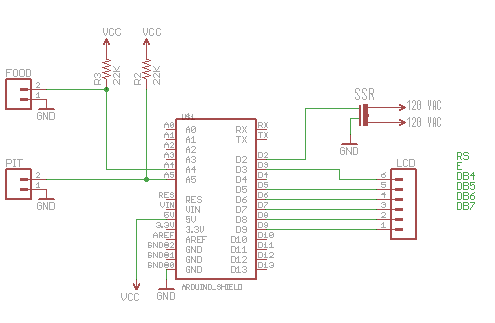

Okay I've grounded the heatsink just in case.  Also made up a quick schematic for how this is all laid out (actually stole and modified one from here)
I'm thinking it might be nice to add an LED that indicates when the heating element is switched on... would I just wire that to the same +5 and ground as is going to the SSR?
Should be OK as long as you don't exceed the current requirements for a single pin (under 20ma should be safe); remember your current limit resistor for the LED, and check the spec on the SSR for the current needs of the control side - but you should be OK.
