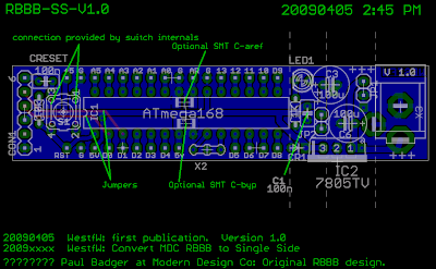

Paul Badger of Modern Device Company designed the "Really Bare Bones Board" (http://moderndevice.com/RBBB_revB.shtml) and placed the design in the public domain.  (Thanks Paul!)
I've converted the design to the EAGLE CAD package, and in the process I noticed that you can pretty much make it into a single-sides board as well, probably not to hard to make using hobbyist materials.
It's not quite the same as the MDC version; the power jack is different, there are no mounting holes, and I think you might have to be careful about "shortening" the board to make sure the power connections stay intact, but the core functionality has tested out (it uploaded and ran blink.)
Pictures show here: http://www.instructables.com/id/Single-Sided-Really-Bare-Bones-Board-Arduino-in-EA/
CAD file downloads here: http://www.geocities.com/westfw/electronics/RBBB-SS-EAGLE-v1.0.zip
Like the original, this design is placed in the public domain.  Enjoy!

cheato9
Hey,
Great stuff, I was wondering, probably a rookie question, what is the X2 "Ceramic resonator" on the bottom of the board? I can't seem to figure that out. And where does the crystal go (if needed)?
I was looking at something similar, the "Stripduino", would it be similar to a part form there?
Thanks in advance, and sorry if it's a rookie question!
cheato9
Sorry, it wouldn't let me post a link in my first post. Here is the "Stripduino" I mentioned -
http://www.arduino.cc/cgi-bin/yabb2/YaBB.pl?num=1251164103/0
westfw
A "ceramic resonator" is an alternative to a crystal.  Slightly less accurate and somewhat more rugged, the big advantage as far as the RBBB-type board go is that they are available in a smaller three-lead package with with built-in capacitors, so you only need three holes instead of six.  They're also supposed to be cheaper than crystals (especially since you don't need caps anymore), but my observation is that crystals are much more available in the hobbyist marketplace, so this part doesn't hold up too well.
You can see what one looks like in this picture of the freeduino:
Using a crystal with the RBBB-SS board would be tricky - there is currently no spot for the caps...
