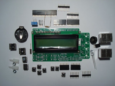

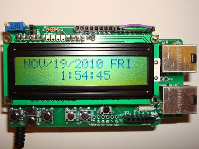

I've designed a shield for beginners to learn and prototype with character LCDs, buttons, real time clock, EEPROM, and GPS.
The shield makes it very easy to use the above parts so a user can concentrate on his/her project ideas instead of which wire is connected wrong.
The shield is compatible with arduino UNO, MEGA, and Duemilanove. It also has spots for two RJ11 jacks so you can extend your arduino's reach as far as a phone cord can take you, without messing with wireless or jumper wires or screw headers.
Details and sample codes are posted on http://liudr.wordpress.com
Here is a couple of pictures:
Here is a video of an alarm clock I made:
[media]http://www.youtube.com/watch?v=L-3pKtf1VBE[/media]
