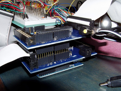

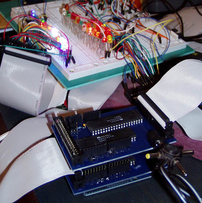

Here are some photos of a triple stack that I'm building up.  2 CCShield boards and 1 Duemolovo:
This one shows it powered up & controlling a bunch of LEDs
