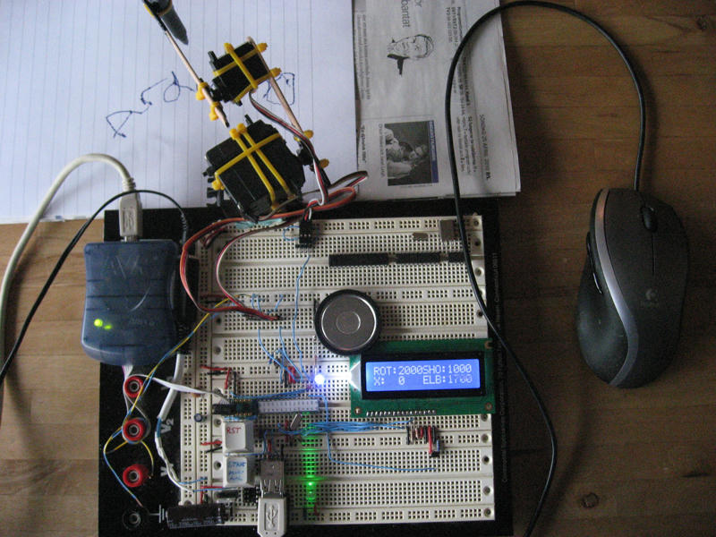

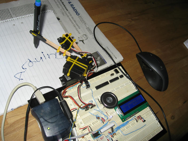

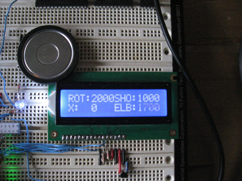

Hello folks! I have fiddled with the AVR Studio and the Atmegas for some time, but i have to say the Arduino environment is so much faster to work with! I started making some general initializations of the basic interface devices (lcd for debugging, servos and a usb mouse) and put them together. It all took the entire weekend, something that would have taken weeks for me in the AVR Studio environment, thanks Arduino-developer-people!
However, i linked the PS/2 library to 3 RC Servos, writing to them in microseconds, did some patterns and scaling. The LCD is backlight controlled via PWM and has a LDR controlling the brightness (doesn't show too much in the video i'm about to put up soon) and added a pen to the outer servo arm. My original intention was to make a gripper holding the pen but i was lacking another servo. I did also have plans for reading a cutoff-current from the gripper to grab things with the right force, but that comes in time.
This is a project to test my own and the IDE's potential. The servo holder thingy was built in like 15-30 min, so nothing fancy. It is only a protorype of what to come.

Great job; but one thing is making me "cringe":
You have wires and cables wrapped around your power binding posts; now, I can't see if they are actually connected to any source of power - it kinda appears they aren't. Regardless, don't let this become a habit - binding posts for power should -never- have anything wrapped around them like that; if there were power, you can easily introduce shorts and possibly spurious signals, or apply power where you don't want it. All in all, it would lead to bad things (from transient errors - to fire!).

Another thing that could be awesome would be to make it write messages smiley
Send it a short message, and it writes it. Maybe even with some "endless" paper (the stuff from printers) and make a device that could pull it a little forwards after each message...
oooooh (sorry, imagination is going crazy smiley-razz), maybe some kind of link to a webpage, place a webcam over, and let visitors write a message on the paper, and watch the printer write it.  ;D

BLD: those are great ideas! But my very prototypic platform is barely able to write with constant human control as it is, you'll see in the vid coming (uploading as we speak, 400mb into youtube smiley-razz ). Maybe I'll make a better stand for the servos in the future, then your ideas would be most possible! Especially if I recorded the movements of some specific letters. But that seems like very much more coding than mechanical work, and I am more in to mechanics/electronics than plain programming, but still a possibility!
cr0sh: I know what you mean... but I have a good explanation. The 7805 is a 2 amp one, getting extremely hot from using it, and the servos are quite slow with it. I then added an external battery pack via the posts, and the wires only coming in to the servo power line (I then disconnected the two wires coming in to it from the regulator of course!). So it was only a temporary solution. I also have no good connectors to the servos, hence the fried Hitech HS-55 (burned some transistors in it, and they are even smaller than usual SMD's!!).
So this was somewhat of a rush project. My imagination is also goind crazy and my head is aching of all new ideas im having. Thinking of getting some accelerometers/gyros and experiment. Then I have my ongoing humanoid experiment (animation on my youtube, I'll write the link as soon as it is uploaded)
