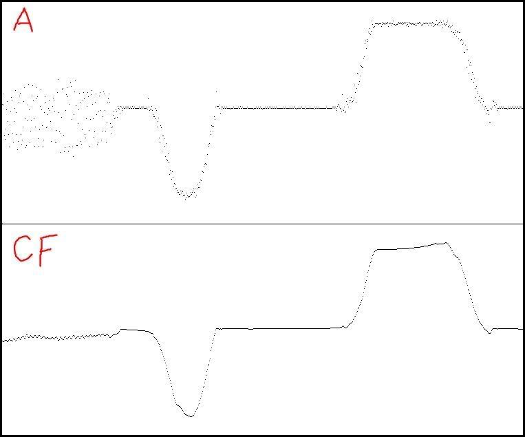

Sep 17, 2009, 06:13 pm Last Edit: Sep 17, 2009, 06:30 pm by ardvark Reason: 1
Here is an example of complimentary filter performance on one axis. The top panel is the accelerometer output and the bottom panel is the comp filter output (x-axis: time). I picked the NC/MP combo up, rolled 90 deg, put in down, picked it up, rolled 90 deg the other way and back, and then started to shake it

Sep 17, 2009, 06:19 pm Last Edit: Sep 17, 2009, 06:25 pm by ardvark Reason: 1
Here is the code that includes the complimentary filter:

This is shown graphically in the figure, where the NC/MP is first lifted from a lying position and then returned to a lying position.
More quantitatively, I can tell you that the 'repeatability' limits of orientation measurement comes down to accelerometer performance. If the accel gives you the same value when returned to a specific position the comp filter will do the same, but will take longer to reach that value (see in the figure how the CF output 'creeps' towards the accel output when the NC/MP is stable). How long this takes depends on the choice of tau.

Ah nice. so we prioritize accelerometers with taf.
