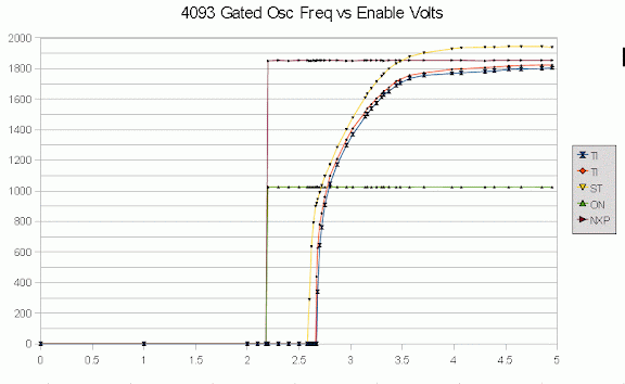

Howdy, home from the high desert ca Edwards AFB, from the Closed Source world, and trying to re-engage the Open Source world.
The only technical obstacle to DCDW was the misbehavior of "Schmitt Trigger NAND Gates" as "Gated Oscillators" which some manufacturers turned into "Voltage controlled oscillators". This made problems for the "swarm of motes" using "sensor plus ID" mode.
NAND gates that do NOT work are Texas Instruments and ST Semi.  NAND gates that DO work include ON Semi and NXP.
As long as you buy NAND gates from ON or NXP it works fine.  Let us set aside for the moment arguments by certain Gods that microcontrollers are becoming cheaper than NAND gates.
Here is the proof
OK these chips waiting on my doorstep were too much temptation, this was fun, but I got a car that wont start, travel expenses to submit, a tree that fell and damaged the house, laundry and much workto catch up on.  Thanks all for your patience, More DCDW soon.

That's actually pretty cool.  One thinks of this sort of chip as being a "jelly bean" that would be pretty much identical from any manufacturer, but that certainly appears not to be the case.  Even the differences between the (working) ON and NXP parts are pretty dramatic...
Are you planning on trying an of the 74xx132 family chips?  NXP apparently has a 74LV132 that operates down to 1V (and up to 5V)...

hey westfw thats a great idea.
74LV132 data sheets from Phillips http://www.datasheetcatalog.org/datasheet/philips/74lv132.pdf and from NXP http://www.nxp.com/documents/data_sheet/74LV132.pdf and even TI http://focus.ti.com/lit/ds/symlink/sn74lv132a.pdf show logic symbols with an independent Schmitt trigger for each input.  DigiKey carries NXP and TI.  Apparently TI does not supply these as DIPs but in the interest of science I'll spring for a SOIC adapter just to prove TI version of 74LV132 doesnt suffer the same problem as their 4093.
Then I can add the TI 74LV132 data to my graph and finally post a credible response to TI's snarky dismissal of my complaint on the their support site.   smiley-twist
BTW The frequency depends also on the hysteresis, wider band = lower freq, thus the significant difference in the free running rate between manufacturers.  But (for the chips that "work right") the graph is absolutely flat which is what DCDW needs for the "swarm of motes" using "sensor plus ID" mode.
