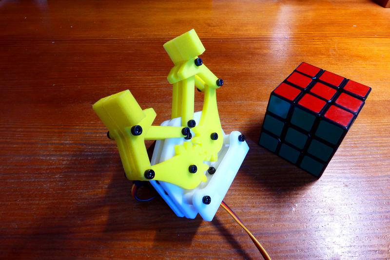

@ matelot,
Check your mail   ;)
This is the new 3D printed gripper V2
simpler to build, only M3 screws and some filament
no more washers, servo's horns and standoffs are now embedded in the relevant PLA parts
This instance is fitted with a mini top plate, to expose the internal mecanism
This gripper was printed @40mm/s with 30% infill, no support needed
Let me have your comments
