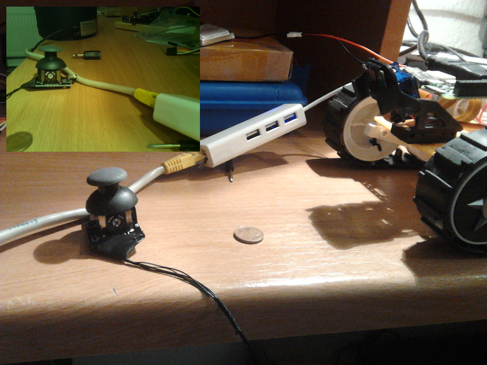

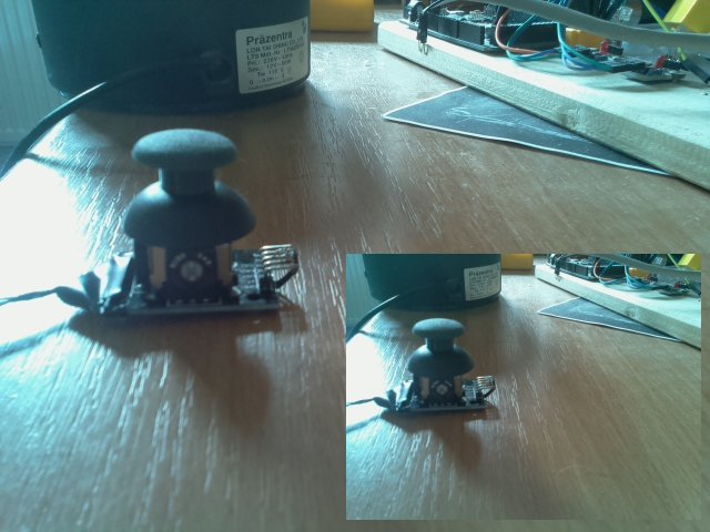

Today I received another caterpillar robot platform, this time without problems with custom office:
I do want to place a Raspberry Pi Zero with camera onto Arduecat, later for line following, now for evaluation on how 90fps on robot video looks like, whether vibrations in high speed runs are a problem, ... . But the current Arduecat is quite full already (today I added mini digital voltmeter that runs completely independent of Arduecat's Due):
I knew that motorshield v2 had problems, so I tried with an Arduino Uno and a motorshield v1. Because of high speed and trying to avoid any power spike issues, I decided to control the platform with x/y joystick and long cable (self-made, 4×2m copper cable, taped together):
On the plus side, it really works, and controlling the robot is quite intuitive (at least to me) given the sketch I wrote:

Here is a youtube video of a demo I did with Android camera lying on catwalk in our living room, 2m above ground:
https://www.youtube.com/watch?v=FkLj-K7Rl6Y
On the bad side, after some time the robot did not move nice, and later it stopped to move at all. It turned out that two of the three L239D motor controllers of v1 shield get very hot. Definitely too much current.
But after some phase of no activity (just release joystick into center position, the robot stands still without motor movement) all works fine again (the L293Ds have become cold again then)- So for the camera test drives the current solution seems to be good enough.

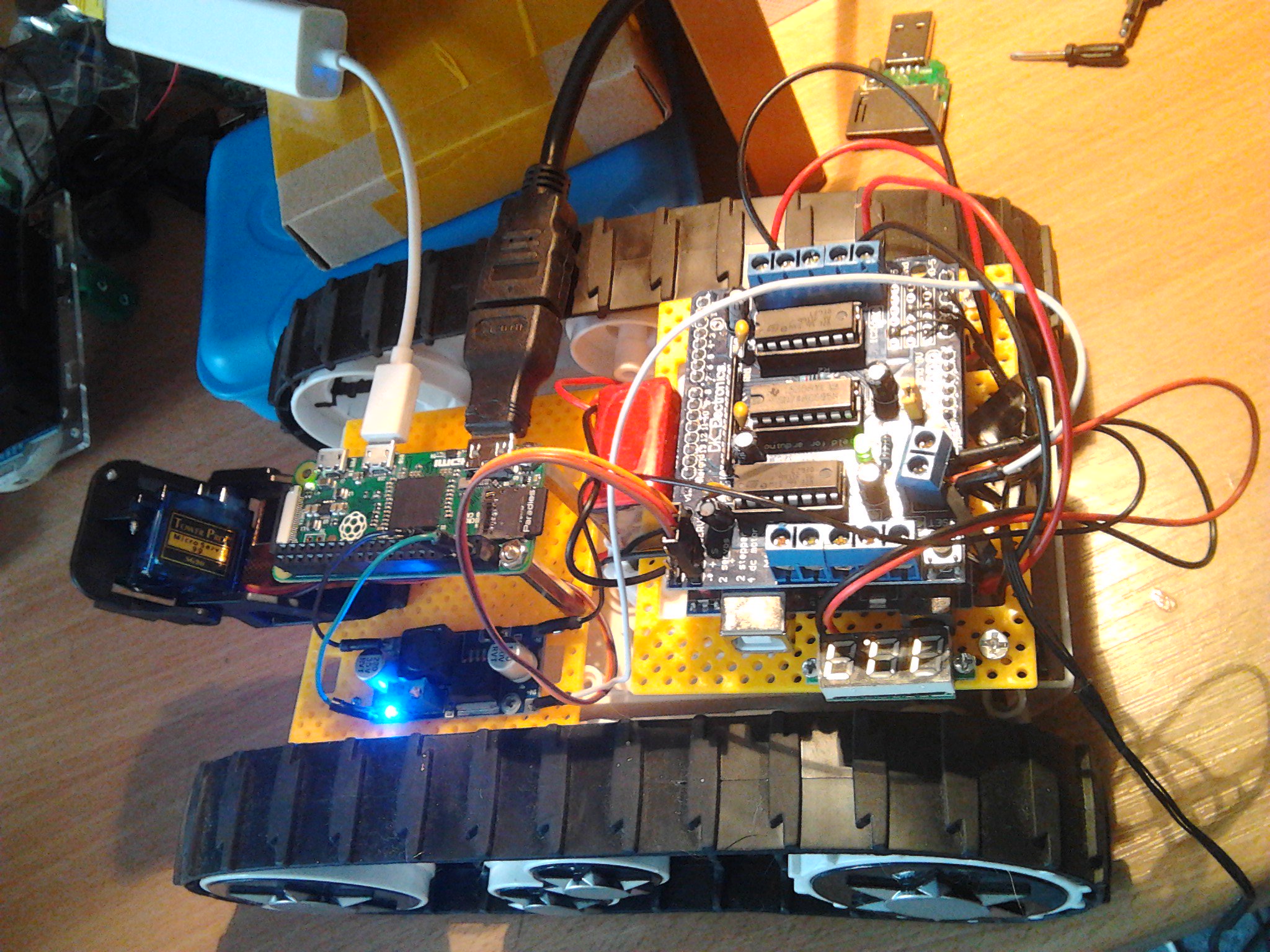

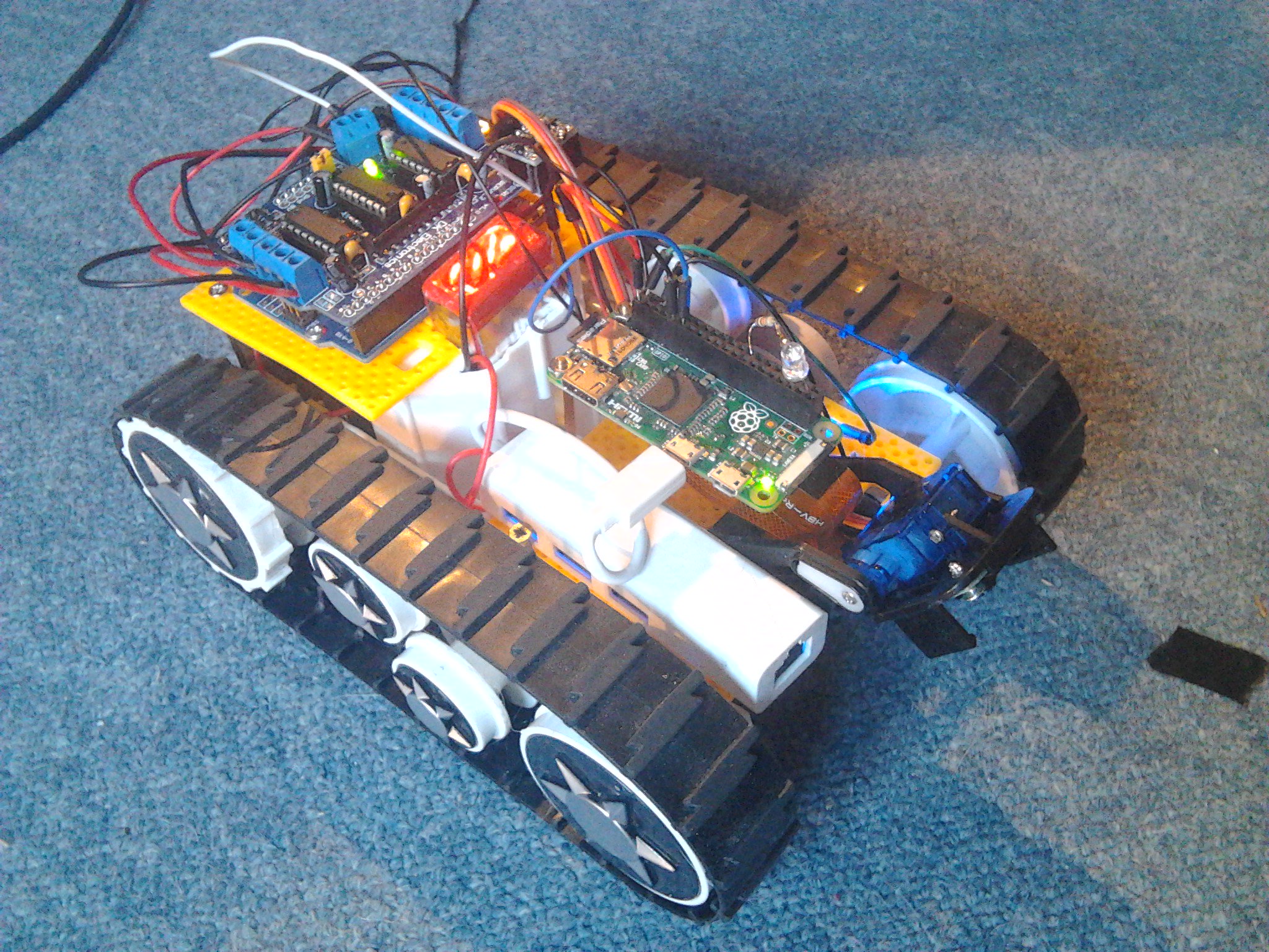

The robot platform sometime did funny things, here it took (joystick) control away from me ;-)
Next I found out how to mount tilt system with Raspberry camera, and the Raspberry Pi Zero itself on two long spacers, so that the flexible camera cable has pace below Pi Zero to move fore and back. I learned that the Pi Zero could not be powered by Arduino Uno GND/5V - it works for some time, but whenever Arduino Uno makes camera servo move, the Pi Zero did reset. So I did power Pi Zero wth 5V from LM2596:
Experiments revealed that camera inclination of 35° was good to see ground in front from 8cm up to 1m ahead:
I have always done 90fps slowmo videos with 640x480 resolution, because I could. In between I realized that 320x240 @90fps might be sufficient as well, at least the lower right 320x240 photo looks not worse than total 640x480 photo:
For some reason the video taking only works when USB to ethernet adapter was "onboard"?!?
I bought a Pi Zero W when it was first available, and it worked really nice. I killed it after one week, most likely by 5V cable unplanned contact with Zero W pins. I am waiting for my 2nd Pi Zero W to arrive next week -- that way I will definitely not need an onboard ethernet anymore (and streaming video for 1st person view will become possible).
This is first "fast" driving 90fps slowmo video taken by the onboard Raspberry Pi Zero and camera. It is surprisingly "stable", I was not sure what the high speed caterpillar platform movement would do to the video. Remember that the video gets played slowed down by factor 90/25=3.6:
https://www.youtube.com/watch?v=AskkaUFikT4
I am not sure whether there was a wall crash at the end of first fast forward phase, or whether robot stopped just before the wall. If, then it was the camera tilt system.

I use the Pi Zero in "slave" mode, and the Uno signals when a video should be taken. Therefore a 5V/3.3V level shifter was necessary. I do use Servo2 pins for controlling the camera servo. But Servo1 pins (D10/5V/GND)were available. I did solder female headers below the level shifter and was able to just put the level shifter onto Servo1 pins:
Finally I added a soldered LED/1kΩ pair to Pi Zero, that is turned on by Pi while raspivid runs:
I changed the previous sketch for robot platform joystick control only slightly. The triggering is done in "setup()", so that the request for taking a video is done by pressing reset key:

Today I let the robot run on living room floor tiles.
2.36m/s (8.5km/h) onboard video is surprisingly stable on floor tiles.
90fps slowmo video played slowed down by factor of 90/25=3.6:

I have to say that controlling caterpillar robot with joystick as I did the last days was not that difficult. But trying to follow the line definitely was really difficult for me (the first 27s of 90fps slowmo video without much activity are 7.5s in reality only), as you can see in the video. Good that the robot will do the line following alone, and much faster ;-) So this is the 1:39min youtube slowmo video (of real 27.5s):
https://www.youtube.com/watch?v=yE5liAQEJdk&feature=youtu.be
Below sketch contains advanced camera control. Since the joystick switch does not work, recording here gets started when moving joystick completely to the left, or stopped when completely moved to the right. But only with no Y axis (speed).

  myservo.attach(9);
  myservo.write(90);
  myservo.write(50);
  x = analogRead(A2); y = analogRead(A4);
  if (y < y0) {
    Y = map(y0 - y, 0, y0, 0, 255);
    ml.run(BACKWARD); mr.run(BACKWARD);
    Y = map(y, y0, 1023, 0, 255);
    ml.run(FORWARD);  mr.run(FORWARD);
  if (x < x0) {
    X = map(x0 - x, 0, x0, Y, 0);
    ml.setSpeed(X); mr.setSpeed(Y);
    X = map(x, x0, 1023, Y, 0);
    ml.setSpeed(Y); mr.setSpeed(X);
  if (abs(y - y0) < 15) {
    if (x < 25) {
      digitalWrite(10, HIGH);  // start recording
    } else if (x > 999) {
      digitalWrite(10, LOW);   // stop recording
#if 0
  Serial.print("Y = " );   Serial.print(Y);
  Serial.print("\t X = "); Serial.println(X);
#endif
  delay(2);

Did other outdoor runs.
This is full HD (1920x1080) 30fps video:
https://www.youtube.com/watch?v=slxG7Y09XXE
The advantage of 30fps is that youtube player as well as makeagif show the video nearly at real speed (factor 25/30 = 0.83 slower).
Slightly downhill the robot did more than 8km/h and I had to run and do joystick control:
Here is a 90fps slowed down run, 91m downill (5°) in 2:15min/3.6 is 8.7km/h:
https://www.youtube.com/watch?v=S-MtuM0nQCU
At the end of the video the robot overturned and ended upside down ;-)
Hermann.

Yesterday I did mount the new Raspberry NoIR camera on my prototyping caterpillar platform:
I had to cut away some plastic parts of the tilt camera holder, and finally found a solid mounting position, where I needed to drill one whole only for 3rd screw. Here are the details:
With the normal Raspberry camera the flat cable had a nice S-shape below Pi Zero W:
Unfortunately the Raspberry NoIR camera has connector on other side as normal camera, so that the flat cable need a 180° turn below Pi Zero W -- not nice, but seems OK for now, perhaps later the Pi Zero will be mounted turned 180° on the caterpillar platform to get back the nice S-shape:
This was a first test photo (2592x1944) taken with shutter open, there are colors:
After closing shutter this was taken in darkness, just lit by the 3W infrared LED mounted with NoIR camera:
Hermann.

Today I was out again with caterpillar robot.
Until now caterpillar robot did outside driving on stony ground.
Today I did change that, wanted to drive downhill a grassy hiking path.
In order to protect the camera I built a cage of Lego pieces and screwed that onto the robot platform:
Here you can see the camera lense, cage is big enough to allow for tilting:
OK, this is the hiking path the robot should turn right into:
This is hiking path from my eye height:
Near ground the scene looks a lot more challenging:
Find 90fps NoIR camera slowmo video on youtube, the initial camera view is even more challenging:
https://www.youtube.com/watch?v=vcdQmnmaQ00&feature=youtu.be
In initial picture you can see houses on the other side of creek Wimmersbach at same height (asl), hiking path direction down. Slowmo video is played factor 90/25=3.6 slowed down. In first phase until 12s robot enters downhill part, all is fine. In second phase until 20s robot moves even steeper down until it ends in a steep of grass. Next it moves out of that until it ends at 27s in next steep of grass. From there until the end of the video (1:54min) robot tried to escape forward or backward several times, without success.
I had to wait in between several times because the L293D motor controller is undersized for the motors and gets so hot, that motors did not move anymore. That motor controller was used as a temporary solution, but nothing lasts longer than temporary solutions ;-)
In a next run one cable from joystick wrenched off, I had to solder it again back at home.
I will revisit this downhill hiking path with caterpillar robot, but only after changing motor controller to TB6612FNG proven good on the other caterpillar robot with ultrasonic distance sensors.
Hermann.
