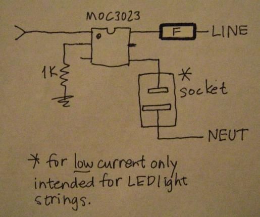

So, I had a "great" idea this morning to get around the TRIAC and the holding current.
I couldn't wait to get home to try it out.
What's the deal?
Don't use the TRIAC!    :)
Just use the triac driver.  It can handle the low current demand of one LEDlight string.  Don't push it; it's one each.
And works pretty good it does, I must say.
Before anyone gets too excited, it still needs a zero-cross reference (see my blog.)
And it can't be triggered on like a TRIAC, the logic input must be kept active throughout.
So, I still delay from the zero-cross then I turn on the MOC3023 and hold that for nearly all of the alternation.  Then it goes back and waits for another zero-cross.
Here's the modification
See more at my blog
http://incredulist.blogspot.com/2012/11/ac-phase-control-triacs.html

I got out my TRIAC circuit and ran it with the sketch above and it worked great.
One low current, same as in the latest demo.
The difference is that it keeps the Gate on throughout the conduction angle, dropping out just before the alternation ends; it does not merely trigger (pulse) the Gate at the beginning of the conduction angle.
A TRIAC can handle more current, so you can do more strings (or bundles, or strands, or whatever you've got.)

> > > I have to walk that back some.  I had put the scope away, but I decided to bring it back out and have a look.  Despite improved fading over the way it was before, I saw on the scope that it was only conducting on one alternation, asymmetrical.  Then I plugged the 40W lamp in with it and it looked even better than with the MOC3023.  It's totally textbook with the lamp plugged into it.
So, one "strand" isn't enough to do it with the TRIAC.  My strand takes 20ma.  My TRIAC's (BCR8N) holding and trigger current are both 100ma, which means a load of at least 12w (ballpark). Maybe 5 would do it to it, but I don't have that many to confirm.
Still, the MOC3023's aren't a bad way to go for this application.
