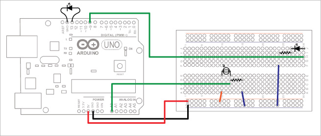

GSWA - Example 07 - P69 - variable not working
Platform: WinXP / Arduino UNO
Sketch: (see below) An edited Example 07 from Getting Started With Arduino.
I'm trying to find a way to make the LED at Pin 9 present a wider scope of intensity depending on recent exposure feedback from the LDR. So I've been setting up variables that might be helpful for something like that.
For some reason, my brightness variable keeps coming up zero.
A manual calculation quickly shows we're not in the ballpark for what brightness should be. I double-checked with a spreadsheet of outgoing variables. (See highlighting for quick reference.)
It compiles, so it's probably not a syntax error. I'm guessing it has something to do with 'int'. Can someone explain to me what's going on with that value?
Example serial data, pinout and sketch follow for reference.
Cheers
Example Values - Serial Port Monitor:
val = 203 | ravgval = 181 | hval = 203 | intensity = 50 | brightness = 0 | thisTime = 5154

Board Pinout:
Sketch:

val is going to be in the range 0 to 1023. When you divide the value by 4, you reduce the range to 0 to 255. These are integers.
Next, you divide the integer by 254. This will result in a value of either 0 or 1. If the value in intensity was 254 or 255, brightness will be 1 * hval. Otherwise, it will be 0 * hval, which is 0.
Integer arithmetic may not be what you want to be doing.

Intensity divided by 254 gives me a percentage.
No, it doesn't. it gives you a ratio. But, the division is integer division.
Intensity calculates on the fly to be somewhere between 50 and 30.
Dividing 30 by 254 gives 0. Dividing 50 by 254 gives 0.
If I take my data into excel:
Sure. Because excel doesn't distinguish between integers and real numbers. C and the Arduino do.
In excel, (50/254)*203 = 40. In C, (50/254)*203 = 0, because 50/254 = 0, because both values are integers.
Now, (50.0/254.0) * 203.0 will give 39.96063 as a result, because all the operands are floats.
By the way, you would get different results if you changed the order of the operations. Multiply first, then divide. The result is still integer math, but the result would not always be 0.

Is there an easy work around for int, or should I try float?
PEMDAS - Parentheses are your friends, eh?
I changed it to a float. It works now, though maybe not as expected.
