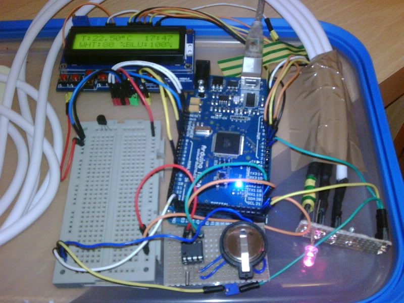

Aquarium Reef Controller, stage 1, the LCD shield,

made a basic temp probe today (1 meter length, just soldered together and heatshrinked at the probe, but not encapsualted.
although this works the cables alittle messy, i'll probably go to my local maplins store (electronics specialist/exstortionist) and pick some 3 wired wire use that. get a better finish at the end i reacon.
Things to do :
Work out coding to worked out an LED photoperiod etc
Write soem code that lets the user set up which probe is which, at the minute the probe alocation is on Hex code not user choice etc.
