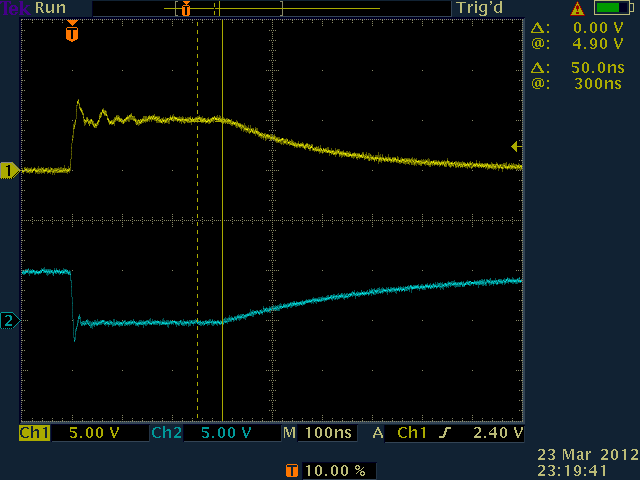

To anybody still reading this topic, I offer the following code. It generates reset pulses of varying durations, and indicates which if any are successful. After reset it checks the state of the registers and lists any which do not match the expected values. Read the comments before running.
Self-reset test sketch
Made for 16MHz ATmega328-based Arduino
To use:
- Compile, upload, and launch the serial monitor (57600 baud)
- Update the register values in checkreg() to those reported.
- Recompile, re-upload, and check there are no "Register" messages
- Cut the auto-reset connection if present (the track between the solder pads marked "RESET-EN on Uno boards)
- Connect Pin-2 to Reset
- Optionally, connect Pin-3 to an oscilloscope and a resistive load to show when the port is reset.
Disabling Auto-Reset is optional, but required for testing with very short pulses <1ms (do this *after* uploading and checking this sketch)
To re-enable Auto-Reset on an Uno, dab a spot of solder between the pads where the track was cut.
NB. Whilst Pin-2 is connected to Reset and the sketch is running, do not push the reset button (will short Pin-2 to ground)

Oscilloscope traces from an Uno r2:
Yellow = pin-3 (connected via 10kOhm to ground)
Blue = pin-2 (connected to Reset, and two resistors (internal + 10kOhm) in parallel to Vcc)
A 250ns pulse is insufficient to cause reset and sketch execution continues. Note the rapid trailing-edge of the pulses.
Pulses 300ns or longer trigger reset. After 300ns the port outputs go high-impedance. Note the slower voltage decay.
