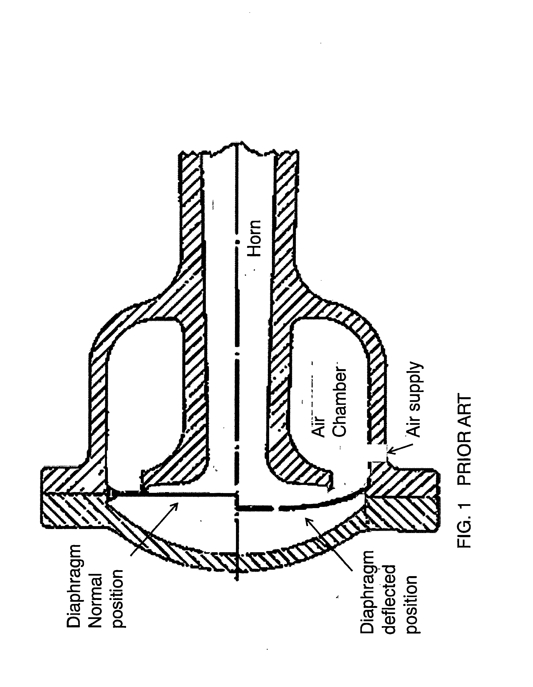

The Hornblasters or train horns look really interesting. They seem to work with a vibrating membrane, the frequency of which is "locked" by the length of the horn, just like with real brass instruments. In real brass instruments you have to blow the somewhat right note with your lips, and the fingering, which sets the length of the tube from the mouth piece to the bell, just confirms the tone. So these Hornblasters might have some preset tension in the membrane for each desired tone. And then the length of the horn just confirms the right tone or frequency. If a trumpet player's lip tension doesn't meet exactly the length of the horn, it's still the length of the horn that sets the right note. This might be true with the Hornblasters, too (my guess). So what I'd like to test is cutting the Hornblaster right at the root of the horn-bell part, leaving a hole just at the membrane cup. Then I'd attach a horn instrument without mouth piece to the hole.
First I'd test the membrane (diaphragm) without the attached horn instrument. I'd run air from a compressor through the thing. I'd try to vary the pressure to see if only changing the air pressure would change the produced frequency in the membrane. If that doesn't change the frequency (pitch), I'd need something to change the tension of the membrane. If that starts to work, I'd be ready to attach the horn instrument. What it would need is something to control the pressure of the supplied air, maybe something to control the membrane tension, and three sollenoids pushing the valves of the horn instrument. Everything disguised in a paper mache mannequin.

This is probably getting out of hands with expenses, but I have an idea how to emulate lip tension and air pressure. I'd even use a real trumpet mouth piece. The mouth piece touches the membrane from one side, like in the image. From the opposite side a large ring presses the membrane against the mouth piece. The whole membrane capsel has to be large enough for this tension ring to fit in. The tension would be adjusted with a solenoid. The air pressure would be controlled by a pressure control valve. The source of air would probably have to be an air compressor large enough not to have to run while my trumpetist is playing. And a pressure lowerer adjusted to the highest pressure needed. And the actual pressure control valve, which sets the pressure for each note, while the solenoid sets the tension for each note. While solenoids or linear actuators push the valves of the trumpet.
