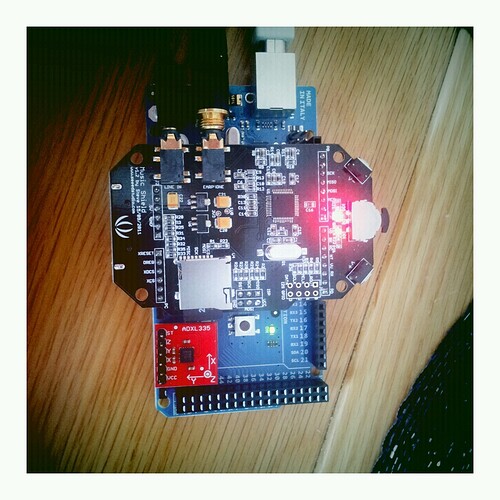

I have encountered a problem I lack the direction to fix. I need a push in the right direction.
I want the record function of a seeeduino music shield to be triggered by an accelerometer via a Arduino MEGA. The problem being the record function is currently set so that you have to
Press play/stop knob before pressing the RESET button of Arduino.
Release RESET button for a second and then release play/stop knob.
When the music shield is beginning to record, the green and red LEDs will blink synchronous.
Press play/stop knob will stop recording.
The demo code for the shield is

I'm trying to integrate it into this accelerometer code that will currently 'do something' when the arduino is tilted past 30 Degrees on the x or y axis. If there is a way of doing it with an 'if' statement then I am already set up for that.

The problem being I do not know how and I need a hint from someone with more experience than myself.
Might I have to write or edit some library pages?
Is it the hardware on the Music Shield that is already set to record in this way? If so, can it be changed within the Arduino 1.0 software?
I'm not sure where to go from here. Thank you in advance for any light you can shed on this subject.

I currently have the accelerometer's angle effecting the record or play functions when the arduino is reset.
I want the reset to be controlled by the accelerometer as well.
A0 is used for Reset of VS1053.
Is it possible to reset the shield with this?
Here is my code and project.
