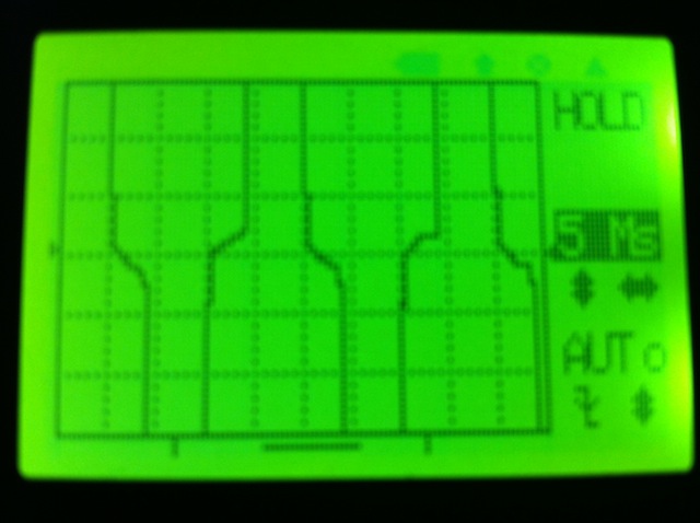

I very much enjoyed those videos you achieved some very cool effects.
I have a neat project in mind to display the output from my solar panel inverter on our TV inside so I don't need to go lift the hood on the inverter to see how much juice we're generating etc.
The issue currently is that I can't get a decent display on my 4yo Panasonic plasma TV with the TVout library. I can see the content is being displayed, but the sync is messed up so the content is scrolling down and around, and also horizontally everything is whacked.
The hardware hookup is dead simple on a breadboard - following the schematic on the wiki (and shown by OP above).
I immediately thought "a ha! 75 ohm ground resistor required!". But alas that made no difference except to dim the displayed content slightly. The sync was still all over the shop.
The TV will happily take PAL or NTSC input, so I tried both DemoPAL and DemoNTSC with pretty much the same results.
Any thoughts?

I attached my dinky little Jyetech scope on the output and this is what I'm seeing, which looks vaguely correct from what I can tell.
I ordered a Hackvision last week and am now worried it will also fail when it arrives...
Cheers,
G.

pocketscience, could you try running the sketch I've attached to this post and tell me if it syncs? The circuit is similar to TVOut but the sync is on pin 9 and the video is on pin 7. I think my sync code is more correct than TVout, so if it works it might be possible to hack my sync timing into the TVout library.
(The code actually does 4 bit greyscale so if it syncs you can try connecting pins 7,6,5, and 4 through 1k, 2k, 4k and 8k resistors.)
Also sometimes TVout syncs better if you put diodes in series with the resistors. And you may need to experiment with the values of the resistors too.

@stimmer - thanks - will try that this weekend! I did try putting various pots in (1K static plus 20ohm pot, 500 static plus 500 ohm pot) and twiddling that but it really made no difference. Didn't try the diodes though.

Wow, frustrating evening! Tried stimmer's code - no difference, tried 1N4148 diodes - no difference, tried re-working the breadboard - no difference, tried direct jumper connections to composite cable instead of my soldered connector - no difference. Then I realised that removing the sync jumper from pin D9 on my Arduino board made NO DIFFERENCE... huh strange. What if I bang the jumper against D9 on the Atmega328 - bingo!!!! Solid, stable image from TVout demos, and also stimmers ntsc demo (nice pic!)!!
