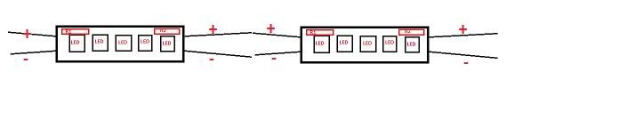

If you put 12V on the end of 1 string, do you have 12V on the other end too? That would tell us the strings are all wired up in parallel, so you need 12V & about 500mA of current.
6W/12V = 500mA.
I checked your ebay source. 12 volts at 6 Watts means 500 ma of current is needed (MAX). You have 6 modules with 5 leds each so thats 30 leds. 0.2 Watts per led. It would seem from the pictures that the leds are wired in parralel, meaning that they all get 12 volts and fight over amps. So voltage dropping isn't a problem. 0.2 watts/12volts gets you 16mA.
So if you're going to power all six, then you need 12 volts at no more than 500ma. If you're going to power one module, you need 12 volts at no more than 83 mA. If you're going to power one LED you need 12 volts at no more than 16mA.
For your 12 volt 700mA power supply, i would just use a 20 ohm resistor or greater. i would use 100 ohm just to be safe.
V=IR
P=VI
What are you saying? No need for any external resistors, that would only hurt by lowering the applied voltage to the modules. The modules are designed to be wired to a constant 12vdc voltage. The modules take care of current limiting for the leds inside the modules. A 12vdc @ 700ma power supply should power all the modules.

WOW, Thanks for the responeses guy & maybe it wasnt as stupid question as I thought.
They came prewired in the string of 6.
"I checked your ebay source. 12 volts at 6 Watts means 500 ma of current is needed MAX" + "For your 12 volt 700mA power supply, i would just use a 20 ohm resistor or greater. i would use 100 ohm just to be safe."
So adding a resistor will "draw down" (bad terminology?) the 700mA to under 600mA making it safe for the lights?
Will a standard 1/4 100ohm resistor be ok? Also, I just wire it in between power supply & 1st module?

"They came prewired in the string of 6. "
I believe you can just hook them up to 12V then, and they will draw about 500mA of current.
Adding a resister in series will only reduce the available voltage and then they might be dimmer, or might not all turn on.
Forget the resistor, not needed, will only hurt. The modules will draw what current the require and no more. You could use a 12vdc power supply rated at 12 thousand amps and still only 600 ma would be drawn from the supply. At your home your typical AC power outlet is rated at up to 12 amps but you can still power a little 7 watt lamp, right?
The 12vdc power source just must be rated for at least 600ma, a little more (1 amp) give the power supply a little breathing space, got it?

For that you'll need a transistor to do the switching.
If you use a part like ULN2003 to control the connection from the -pin to ground, there are 6 PWM outputs on an arduino and you can individually PWM all of the modules.
Thanks for that info CrossRoads............... More learning/info taken in.
After some research I found this response from a "Lefty" to a similar question.
"You can just use a simple NPN power transistor to switch all those led assemblies at the same time. Either just with on and off commands using digitalWrite() commands or vary the brightness by using a PWM supported output pin and using the analogWrite(pin, value) command. A TIP120 is a cheap popular choice of switching transistor. Wire it's emitter to ground, it's base wired to a series 500-1k ohm resistor with the other end of the resistor wired to the output pin. Wire all the +12vdc wires of the led assemblies together and then to your 12vdc source voltage. Then wire all the - leads of the led assemblies together and then wire it to the collector of the transistor. Finally run a wire from arduino ground pin to the - terminal of your +12vdc power source. The power source must be rated for the total current of all the led assemblies totaled"
Is this the same in my case, if i left them as one string? I have some TIP120's that I brought with my Arduino and other bits. I also have some salvaged TIP121's.
