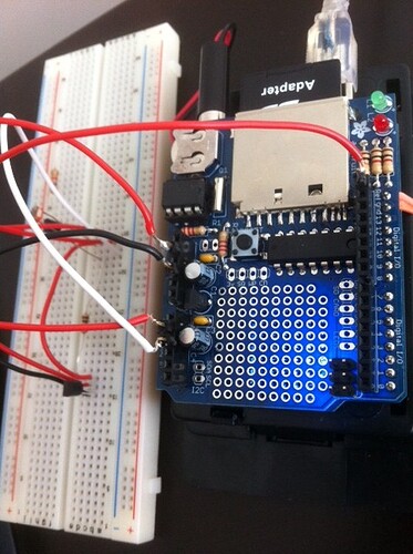

Freezer code error help
Hey guys, Im pretty new to programming so ill probably have a few questions along the way as I try to do this project. Just a quick explanation of what I am trying to do - Im programming an arduino to turn on and off a freezer relay during different times of the day. set the temp during the day 7am-7pm to -5 degrees and at night, 7pm - 7am to -20 degrees. I have the code keeping time, getting the temperature and light values and displaying them and am now trying to write the if/else statements that will jump to the two functions called Daytime and Nighttime. Here is the code:

My issue is with the last If/else statement. The line if (now.hour >= 7 && now.hour <= 19); is returning an error saying:
Complex_TempLight_Clock_pde:75: error: invalid use of member (did you forget the '&' ?)
Complex_TempLight_Clock_pde:79: error: 'else' without a previous 'if'.
Any help would be much appreciated.
    if (now.hour >= 7 && now.hour <= 19);   //If time is between 7am and 7pm print day time setting)
Should be
    if (now.hour() >= 7 && now.hour() <= 19)   //If time is between 7am and 7pm print day time setting)
You missed the brackets off. I also removed the semicolon, which would count as the code executed when the if was true.
THANK YOU haha Ive been sitting here for 2 hours trying to get the brackets in the right spot but couldn't figure it out. Now to wrack your brain again this is what I have added.

So I thought I would post the changes that I saw so that if anyone else is having troubles like mine that they can see it.
he main difference between the two codes is that I originally had a function in a function. I needed to declare my subroutines separately by putting naming them void Nighttime() and void Daytime(). This takes them out of the main routine named void loop().
Another addition was in the setup where temperatureC was defined as a float. Naming this as a float makes the Temperature a value with a decimal point. I read that a floating point math is alot slower then integer math, but since I'm not doing that much math with the temperature value this should be ok.
I have gone through the code and made sure i entered all the {} onto their own lines and used the auto format. This is teaching me alot and I appreciate your help.
The next step is getting it to write to an SD card as well as display it (right now on serial monitor, next on LCD screen). I have the Data logger shield from Adafruit http://www.ladyada.net/make/logshield/lighttemp.htmland had it logging data with the light and temperature logging sketch from GitHub. I then have taken some of the code and tried to implement it in my sketch. I got it compiling fine with no errors. But now it is not showing anything on the serial port, or logging any data to the SD card. Any Ideas?

As an aside - Im asking about code, but if I should be posting in the project guidance section just let me know. And for intrest sake, I attached a picture of the circuit and datalogger shield with the Arduino.
Add Serial.print() statements to setup(), before trying to open the file. See if they appear.
There is no code to initialize the SD card reader. I'm pretty sure some is required.
