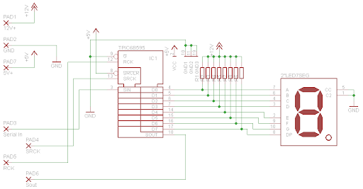

'High' voltage 7-seg LED interface
Here is the circuit diagram. Each display is the same.
Code (once I have it all working correctly I plan to tidy this up a lot, just want to fix one problem at a time). I borrowed the button check function for testing for a long press (sorry can't remember where on the web I found it :-[). The clock came from Rob Faludi and his open source clock.
Count Down Timer
 Usage - Three buttons: Mode, Hour and Minute.
 Short press Mode = Start/Pause timer
 Long press Mode (2.5sec) = Enter/exit timer setting mode
 With timer paused press Minute and Hour together to reset clock
 In Timer Setting mode, press Hour/Minute to increment time settings.
