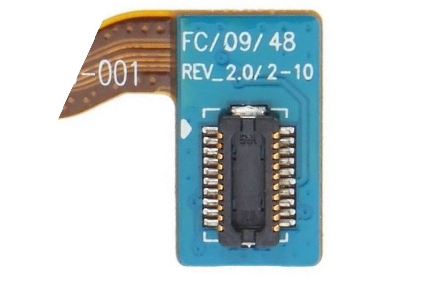

Looking to use a Blackberry Navigation Key / Joystick (from the 9800)  as a mouse input device tied to USB.  Anyone figured out the pinouts and/or signal protocols of this thing?   reference:  http://www.dealextreme.com/p/genuine-replacement-joystick-navigation-key-for-blackberry-9800-81000

I imagine this would be considerably more difficult to use than a blackberry trackball, and possibly outside of the capabilities of the arduino, as this is basically a low-res camera.  The process of reading in data from the cam, comparing the images, and determining motion likely happens on a chip on the blackberry motherboard, and not inside this sensor (camera) .
deejayspinz
Admittedly, I agree.  However, I'm stubborn, so I'm not giving up yet!  I pulled off something similar a while back on my EEE 901 using an Apple MightyMouse (http://www.plastibots.com/?p=37) - which is my backup plan for this project (already on order).   I have 2 of the BB trackpads on order and will attempt to see what makes them tic.  I think you are right though, I suspect the unit consists of an IR LED, some IR receivers and just transmits data to the BB mainboard for processing.  My hope is that the data that is being generated may be able to be interpreted somehow - possibly by the Arduino.  In my case I only care about scrolling up and down.

The trackpad does all the processing onboard as per the research I did. And hence it can definitely be integrated with arduino as it outputs x,y. The statement made by one of the earlier members that it requires image processing to be done by the host controller is a misconception. Will keep you updated about this.
duende_azul
Blackberry 8520 trackpad works much like the Agilent ADNS-3060 sensor, so in fact, using the data sheet that sensor could read offset information (delta_x and delta_y).

The information is referred to the trackpad of blackberry 8520.
First of all, the pinout of the trackpad is this:
(The white triangle indicates the pin 1)
Pinout:
Note1: signals "sig0, sig1, sig2 and sig3" should be ignored because it is not used in this trackpad)
Note2: The signals with "*", they are connected through a 220K resistor to 2.85V and GND.
Note3: The MOTION signal functions as an interrupt signal is set to 0 when there is data to read and set to 1 when already read all the data. Data are reading MOTION, delta_x and delta_y records.
Schematic:
Communication:
Communication with the trackpad is made using the 4-wire SPI protocol.
The SHTDWN and RESET signals must be at logic 0.
According to my research, the records you need to read are:
Product ID (0x00) - Always returns the value 0x0D. Useful in our application to see if the device is present.
Motion (0x02) - Indicates whether there was a tap on the trackpad. Bit 7 of this register should be inspected, if it is 1 no data to read, if it is 0, no data.
Delta_x (0x03) - Indicates the offset in the x axis.
Delta_y (0x04) - Indicates the offset in the y axis.
Delta_y delta_x and 8-bit registers are signed.
There are many more records .. and as I have observed, are similar to the motion sensor Agilent ADNS-3060. Read the datasheet for more information.
