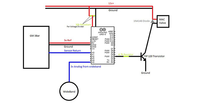

I'm new to Arduino, and programing in C+, but not programing in general. This is my first project, and am looking for feedback from a more experienced audience. So here goes:
I set out to create a closed loop boost controller for a automotive application, those of you not familiar this the concept this is a rough description, the controller essentially pulses a solenoid valve installed inline on the vacuum/boost hose from the turbocharger to the wastegate. It is intended to "hide" boost from the wastegate to keep it closed, which in turn builds more boost.
My Diagram is attached, and it seems to work on the desk, I have not installed it in a car yet. Mostly I'm curious about the quality of my code, is this the cleanest most efficient way to write it? Does anyone have suggestions on how to improve it?

As to your code, I am probably no better than you. But I think you should examine your data types: double, float, etc. Probably don't need 32-bit floating point precision for some of your variables. smarter guys than me will probably be along to give better guidance there.
However, your wiring needs help. Don't use a voltage divider to power the Arduino. (Think that's what is show there?) If you have a good 5v supply from the car, you can use that. Also, you might want to consider using something other than the TIP120. The writer of this article is a little agitated, but he has some good points.

However, here is a part of your code that needs fixed.
if (((Lean >= 2)) && ((unsigned long)(millis() - LeanTime) > 250)) {//Check if lean for more than 250ms (.25 seconds) and lean more than 2 loops
    Cut = 1; //cut boost if too lean for too long
With this, because millis() is already assigned a data type.
if ((Lean >= 2) && (millis() - LeanTime) > 250) {//Check if lean for more than 250ms (.25 seconds) and lean more than 2 loops
You may want to consider using >= 250 as you will have to wait another loop if your millis() - Leantime equals 249 or less.
Also, in the terms of engines, wideband Air/Fuel sensors are fairly slow. Therefore, give yourself a wide margin when you are testing your ideas on your engine.
My schematic skills are worse than my c++ knowledge, but the voltage divider was to keep the arduino from seeing the 14+dcv common in an automotive charging system. If there is a better way let me know please. Also thank you for the link Paulcet, I very well may swap that component in the final draft.
Thank you for the tips on the code cyclegadget.
You can buy an USB adapter that plugs into your cigarette lighter of your car, the use the programming cable of the Arduino for power. An USB adapter can supply enough power for the circuit diagram that you are providing. If you add more parts like LCD displays, you may have to calculate how much current you need to operate your devices.
Resistor voltage dividers can cause problems when used for powering the Arduino. You are better served by using batteries or a power supply with the correct voltage.
You may use a divider on an (analog pin) when taking analog readings so that the voltage range is 0 to 5 volts.
