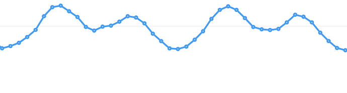

While before this change you could get an notorious decrease in the sampling time from some 38 us (micro seconds) to 1 us. After that I couldn´t get less than 1.5 us.
With this code I get 1 us again:
int x;                                           // read value
  Serial.begin(57600);                           // initialize the serial port:
  REG_ADC_MR = 0x10380180;                       // change from 10380200 to 10380180, 1 is the PREESCALER and 8 means FREERUN

I´m getting a 1.00 us sample time, That is 1 MHz frequency!.
My small innovation from the links is that I changed the PRESCALAR, from 2 to 1. This is in REG_ADC_MR = 0x10380180. I changed the third digit (right to left) from 2 to 1.
The change from 0 to 8 is to enable FREERUN, that means one sample after the other non stop.

I think you can only get 1MHz using dma.
No no. I´m getting 1 MHz with this.
I am only storing it in memory until the measure ends. It´s a big 24000 int array (I should try a short array).
I tested the light output of a compact fluorescent lamp. I will try to add some picture.

You can only get reliable 1MHz sampling using DMA or disabling all (other) interrupt
handlers (which otherwise may cause lost samples by delaying the ADC code or ISR).
Its obviously going to be more powerful to use DMA which frees the CPU for other stuff.

In the meantime, will something like this be an acceptable solution?
noInterrupts();
(fast loop of analogRead)
interrupts():
