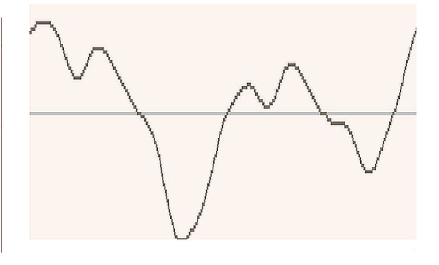

Here is a sketch I have cobbled together to create a "Hammond" sound synthesiser using an Arduino UNO.
It uses MIDI signals and an MCP4921 DAC to pick up the syntheised sound via SPI on a "shield". (I didn't know what a "shield" was until recently, but its a piggy-back PCB that picks up the Arduino pins and contains electronics as required for the project):

I have ONLY tested it on an UNO and with a Casio AP-21 digital piano.
I note that the piano MIDI is of the "running" variety, where it doesn't send a Note ON message if a key is already held down. This necessitated a lot of the coding in the main Loop, because simply outputting each note caused the synthesiser to keep being silenced in a musically unwanted way.
Attached are details on the shield used.
The wavetable was created by recording Middle "C" from a genuine 1960's tonewheel Hammond organ and manually digitising the 256 amplitude values needed for a single cycle of the waveform. I set the 9 drawbars to 636554078 because I liked the sound.
The code sets the sampling rate at 15kHz although this results in higher notes having poor quality. I might try doubling the sampling rate to see if this improves as in theory it should do. The 15kHz is grand for LF audio but the Hammond is able to put out high harmonics and these need to be clear so they don't mash up the sound.
Getting the wavetable followed these steps:
1: Record organ on (phone)
2: Input 1 -2 seconds into Reaper
3: Expand Reaper graphic and select one cycle of waveform
4: Copy & paste screenshot into Paint
5: Expand to A4 size (roughly)
6: Print
7: Over print the print with an Excel 255 x 255 grid
8: Type 256 values into an Excel wavetable file
9: Use Excel chart to ensure waveform is smooth, i.e. no discontinuities.
10: Copy wavetable data into sketch
11: Give it a lash
Hammond.ino (6.9 KB)

Well, I re-wrote the code to provide interrupts at 31250 Hz and it did indeed clean up notes above about C7 with a frequency of 2kHz.
However, it highlighted a previously unknown error in the "midiNotes" table, where I missed out a value - pure typo - which threw out all the notes above, coincidentally at C#7, 2217 Hz.
So please find the revised sketch attached, if you really want it.
