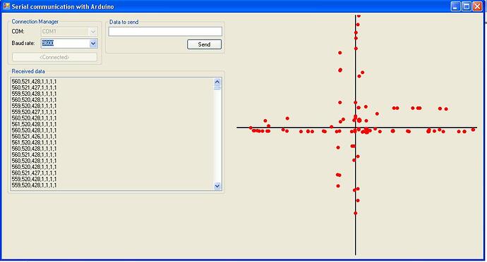

haha funny how this works :slight_smile: i was messing around with my code before you just posted, and did all of that, but it still doesn't work. it will display the X and Y axis when the form starts, but then it should write the dot to screen after splitting the incoming serial data; no dots are displayed on the screen though. ive tried display.Update(); etc and no luck. then i tried "this.Refresh();" under SetText after writing the new dot for X/Y and it works!!! see pic below.
can i make it so that it gets rid of the previous dots so theirs not dots all over?
also the x any y axis' are flipped(like left is right etc), any tips?
