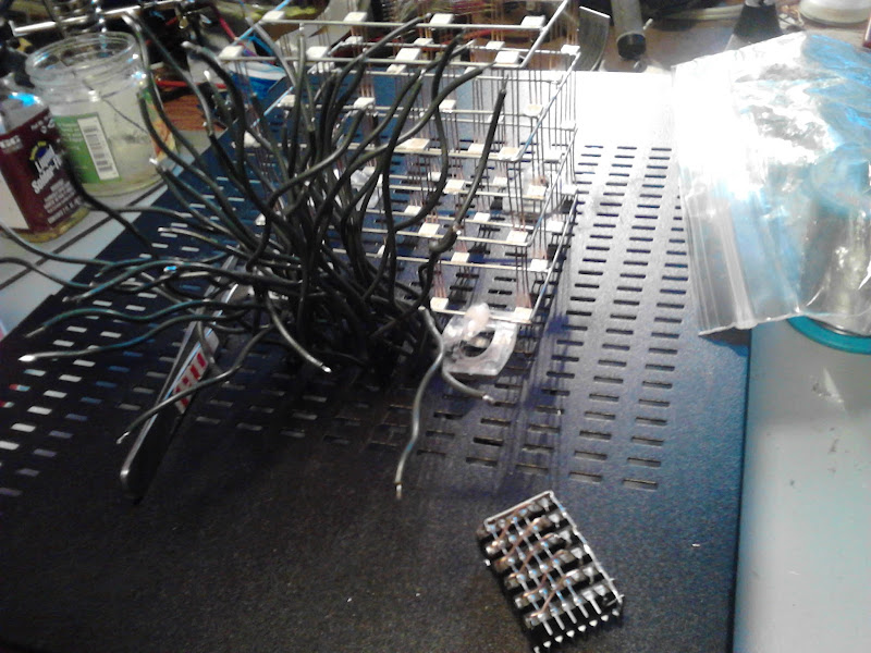

I did a lot of soldering yesterday. I found some unused xmas lights that had wires in groups of 3, about the right lenght for my project. I cut, stripped, tinned, and soldered them onto the resistors that I had previously soldered onto the column wires on the cube. I ended up having to untwist the wires to move them through the case, and it ended up pretty ugly. I will probably end up replacing those wires, but they will work for now.
Before green wires:
After green wires:
The horror!
Soldering away...
Which brings us to here:
Now that I have the shift registers wired up to the ribbon cable (clock, latch, data, ground), and wired to the LEDs, I need to figure out how to source current to the common planes.
In my first cube, I used 20 pins, 4 pins sourced 5v (through 220 ohm resistor). I upgraded that cube to using 2 shift registers to control the sink, and sourced 5v via 4 pins through 220 ohms.
I recently upgraded that cube to 16 100 ohm resistors on the column(sink) pins, and removed the 4 220 ohm resistors on plane(source) pins.
