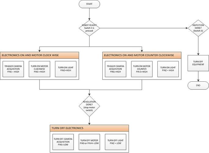

So I have 3 switches
(Switch 1: inspectionready, Switch 2:stopmotor, Switch 3:inspection stop)
so when switch 1 is pushed
motor will rotate clockwise
if switch 2 is pushed stop motor
if switch 1 is pushed again
then motor stop
finally is switch 3 is pushed program will end.
i am having trouble with making switch one to make the motor turn clock wise
then stop when switch 2 is pressed
then when switch 1 is pressed again motor will turn counter clockwise
please help i am a newb...i have looked a bunch of examples....

I see one problem... you assume that LOW is 0 and probably that HIGH is 1. Although that may be right, you should be consistent in your code to prevent problems that are hard to track down.
so this:
int inspectiondone = 0;
and this:
while(inspectiondone == LOW){
May not give you the expected results. I know this is not the problem, it's just an advice.
Then the other thing I see is infinite loops... loads of them...

I did not understand your conditions to start and stop the motor... but I think you are complicating things way too much for what you described. Either way, you don't have infinite cycles in the code now.
As bubulindo observes, your while loops are causing you issues, as written, your program will only read the buttons once. Assuming you weren't pressing the InspectionStop button when the program started, it will spin in the first loop, doing nothing, forever.
A more effective approach would be to build a state machine: you only need a few states - start, cw, stop, ccw, end inspection. Read the buttons at the start of loop & then use a switch statement based on current state to see if the buttons indicate a need for state change. If they do, set your outputs appropriately and change state. Then loop will be called repeatedly, rather than once as you have it. There are plenty of examples of this posted in the forums - I gave one in this thread: What have I done right/wrong? - #9 by wildbill - Programming Questions - Arduino Forum
