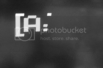

Finally its created an small code to read the vector and load the image to the TV Screen. In figure 2 its shown the resulting output. In code 2 is one mode to read the vector.
Figure 2 - Result image on TV Screen.

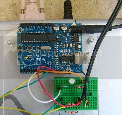

Figure 3 - Arduino Board for testing.
