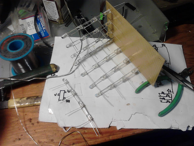

This is a better test program, I've cleaned things up, and added some more programs.
// TransistorCube -- Test Program
#include <avr/pgmspace.h> // allows use of PROGMEM to store patterns in flash
#define CUBESIZE 4
#define PLANESIZE CUBESIZE*CUBESIZE
#define PLANETIME 3333 // time each plane is displayed in us -> 100 Hz refresh
#define TIMECONST 5 // multiplies DisplayTime to get ms - why not =100?
** Defining pins in array makes it easier to rearrange how cube is wired
** This cube uses 2 plane pins and one led pin to light up any single LED.
** Pins 2-13 are used to control the 12 RG and B anodes (the rear to forward 4 LED)
** 5 banks of 4 transistors that are controlled by 8 arduino pins sink the cathodes.
** Pins (14,15,16,17) control 4 transistors that select the row(wide), and on each row.
** Pins (18,19,0,1)4 control 1 of 4 sets of 4 transistors that select the level(height).
** First you have to turn on a row, then turn on a level to sink the LED.
** This cube uses NPN transistors. We send HIGH to sink a row or level,
** and we send HIGH to turn on a anode color/forward/back LED. send LOW turns LEDs off.
int RGBColumnPin[] = {2, 3, 4, 5, 6, 7, 8, 9, 10, 11, 12, 13};
int RowPin[] = {14, 15, 16, 17};
int LevelPin[] = {18, 19, 0, 1};
int RowLevelCount = 4;
int RGBColumnPinCount = 12;

// This bit of programming uses 3 loops to sequence all 192 LEDs
// one loop controls 1 LEDs anode pin, the 2 other loops control the cathode pin.
// You turn a pin HIGH, to light the LED (turn the anode HIGH, and turn 2
// transistors HIGH to sink one cathode line (4 RGB LEDs)
// Turning all pins LOW, turns all LEDs off.
