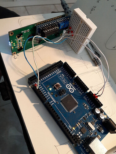

2x16 LCD with I2C backboard
Hello, I'm trying to get an LCD display to work, in order to print some measurements i take but I'm running into problems.
I use an Arduino Mega 2560 board, an LCD display (which i don't know any product number), and a backboard "LCD I2C Breakout board" which uses PCF8574N chip.
My circuit is GND - GND
SDA - pin20 SDA
SCL - pin21 SCL
VCC - 5V
I runned i2c scanner and got 0x20 as an adress which i searched online to found (0x20, 4, 5, 6, 0, 1, 2, 3, 7, NEGATIVE) because the code i used had an adrress like that.
and that is the code

So by using that address i got text instead of bars but only weird characters. So i could really use some help. I have tried many other codes and libraries with no luck. As you may understand i know very little so be patient.
i attach pictures of circuit and LCD, thank you for your time
I've not seen that LCD backpack before.
Do you have a link to where you got it and/or a schematic for the board?
Are there any components on the back of the backpack PCB?
I'm interested in what the 2nd pot is used for.
The PCF8574 requires that the 3 address pin either be strapped high or low since there is no internal pullups/pulldowns on those pins. The PCB looks like they can be jumpered either way but may not provide a default strapping. You need to check this to make sure that they are strapped high or low to set the address that you want.
The i2c address is completely independent of the pin mappings.
The pin mappings in the constructor for that library tell the library how the PCF8574 i/o pins are wired up to the hd44780 pins.
If the pin mappings you tell the library do not exactly match the pin mappings used on your backpack it will not function correctly.
You need to look at your backpack or the schematic for the backpack and make sure that the numbers you enter in to that constructor are for the correct Px pin of the PCF8574 for that LCD function. If any of the eight numbers/pins are incorrect or out of order it will not work.
You could try my hd44780 library package. It will automatically figure out the i2c address and should be able to automatically determine pin mappings.
It also includes a diagnostic sketch that will test the i2c signals and the internal RAM of the hd44780 display.
It can be installed using the IDE library manager and does not require modifying any currently installed libraries.
You can read more about it here: GitHub - duinoWitchery/hd44780: Extensible hd44780 LCD library
The i/o class for backpacks that use the PCF8574 chip is hd44780_I2Cexp and the diag sketch is called I2CexpDiag.
I would recommend installing hd44780 and running the included I2CexpDiag diagnostic sketch.

Several, but it is hard to say without looking much closer at the board.
It could be:
  • Loose wires
  • Cold solder joints
  • backpack design Or incorrect/missing components on board)
  • It has no bypass capacitors on it
  • It does not have the PCF8574 Address pins strapped high or low.
I have no idea what the 2nd pot is for or what the 22ohm resistor (I think that is the value as I can't quite make out the colors) is used for (probably additional current limiting for the backlight)
The PCB looks like it has the holes to solder in 3 three pin headers to allow using removable jumpers to set the address but it would be difficult now to solder them in as the PCB is already soldered to the LCD.
I would recommend soldering some jumper wires to the PCB to properly strap the PCF8574 address pins to set the address.
Leaving them floating may cause issues as the data sheet says that you must strap them high or low.
I'd also recommend soldering a bypass cap to the PCB as that is also likely to cause issues.
It looks like you could use the two holes on the right side of the PCB. The ones next to the GND and VCC header pins. I'd solder in a .1 uf in those holes.
Did you run the hd44780 diagnostic sketch?
I'm curious if it can properly auto detect that backpack.
--- bill
so i run your code and i get this
Serial Initialized
I2CexpDiag - i2c LCD i/o expander backpack diagnostic tool
hd44780 lib version: 0.8.3
Reported Arduino Revision: 1.6.7
CPU ARCH: AVR - F_CPU: 16000000
A4: digital pin: 58
A5: digital pin: 59
SDA: digital pin: 20
SCL: digital pin: 21
Checking for required external I2C pull-up on SDA - YES
Checking for required external I2C pull-up on SCL - YES
Scanning i2c bus for devices..
i2c device found at address 0x20
Total I2C devices found: 1
Scanning i2c bus for all lcd displays
LCD at address: 0x20 | config: P65401237L | R/W control: Yes
Total LCD devices found: 1
LCD Display Memory Test
Display: 0
Walking 1s data test: PASSED
Address line test: PASSED
Each working display should be displaying its #, address, and config information
If display is blank, but backlight is on, try adjusting contrast pot
If backlight is off, wait for next test
Blinking backlight test: to verify BL level autodetection
If backlight is mostly off but
you briefly see "BL Off" on display with backlight on,
then the library autodetected incorrect BL level
and the library cannot autoconfigure the device
I am gobsmacked by the missing 100nF capacitor.
I guess that the 2k2 resistors are bus pullups.
The 1k0 pot is a mystery.
The 22R is possibly a series resistor for the Backlight. The LCD shows a 100R already mounted (R8). Some LCDs have 0R mounted and hence need a 22R resistor.
As Bill has suggested, hard-wire the A0, A1, A2 jumpers. Easy enough to solder some plain wire. e.g. all HIGH for 0x27.

David,
There are several different PCF8574 pin wirings out there. Many Arduino users really struggle with trying to get these backpacks to work, since many don't know how to read schematics or how to trace down the pin connections. Some struggle with even getting the i2c address correct.
This is why I put in so much effort to create the auto detection that is in the hd44780 library.
On the resistor. oops. I meant 220 ohm (Red, Red, Black, Black - Brown).
(somehow the other zero got lost with my typing).
Seems like the the backlight might be a bit dimmer if the LCD has this resistor on it.
But some backlight are way too bright IMO so the added resistor might be nice to lower the intensity.
Maybe the 1k pot is in series with the 220 ohm resistor to allow reducing the backlight current even more?
So 1 pot for backlight brightness and 1 pot for contrast?

The backlight active state detected by the hd44780 library was LOW, so either it isn't connected or is sinking the backlight to turn it on.
The 16x2 backlights don't draw very much current (I have some that are 2ma) and while the PCF8574 can't drive any current it can sink 25ma which is more than enough for most 16x2 backlights.
And if the 220 resistor is on the backlight, then that should definitely bring the backlight current down to what a PCF8574 could sink even on the hungrier backlights.
In fact in a thread a few weeks ago, I walked a previous person though modifying their backpack to directly control the backlight on a 16x2 display since the original design used a FET which does not allow the hd44780 code to auto detect the backlight level. By sinking the backlight directly, the auto detect code can work and the backlight didn't need more current than the PCF8574 could sink.
Now for the 20x4 LCDs, they typically draw from 50ma and up. I've got some that want 450ma !
Not sure why they draw so much more current than the 16x2 displays. I could understand about 4x but not the 12-20x I'm typically seeing.
--- bill
