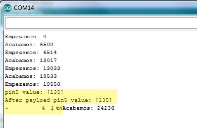

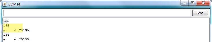

I'm trying to use the xbee library to make a communication between some ZB S2B modules.
I configured them in API mode (2, with escape character), at 57600 bps, and let them to associate themselves. It seems like all is OK. But I can't see any transmitting message between them, even when I use the library's examples.
I modified these examples, only to print message in serial, to try watching more info. I put them below.
Could you help me, please??

Serial.flush();
// break down 10-bit reading into two bytes and place in payload
pin5 = 135; //analogRead(5);
Serial.print("pin5 value: [");
Serial.print(pin5);
Serial.println("]");
payload[0] = pin5 >> 8 & 0xff;
payload[1] = pin5 & 0xff;
xbee.send(zbTx);
Serial.println("Sending TX packets.");
