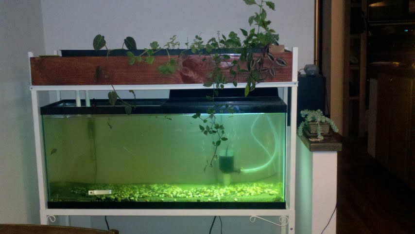

My ultimate goal project involves the integration of Arduino with my aquaponics set up (hydroponics combined with aquaculture), which is also a simultaneous work in progress pictured below: I have broccoli, several types of mint, sugar snaps, 3 species of tropical vines, tomato seedlings, lettuce seedlings, squash seedlings, dill, lemon balm, and a few other herbs and plants with economic value; this is mostly an experiment geared at identifying the fastest and best growing plants in this type of system.

Those pictures are too small to male out any detail. I can't see the battery setup, or what it is powering.

In the tiny picture, the batteries in the holder looked a bit like an LCD.
