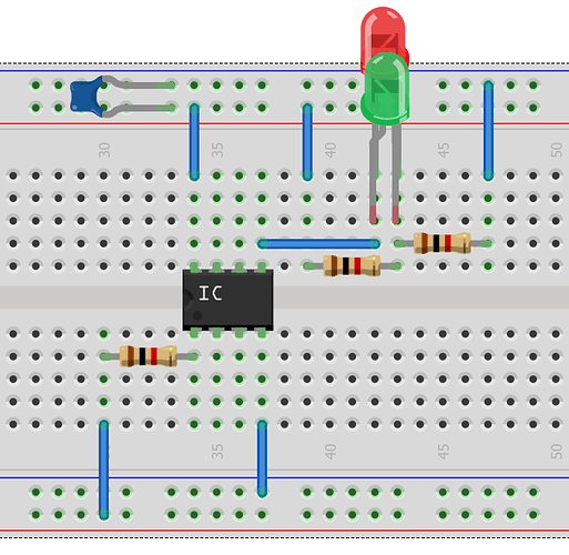

Will an LED blink if noone is looking?
The voltage divider is there to provide 2.5v for the LED bias. When pin 5 is high, the LED sees +2.5v on the AVR side, forward biasing the green LED. When pin 5 is low, it sees -2.5v, forward biasing the red LED. The LED is supposed to work at 2.0-2.1v typical, so that should be OK. Here's the Digikey sales page for it:
Here's the code. Note, this is AVR C for use in Atmel Studio. The intended application is simplistic enough that bringing in the whole Arduino kit doesn't make much sense for this project. 64 bytes of SRAM and all...

Here's a Fritzing snap of the breadboard layout. Powered from the 5v/Gnd pins on an Arduino.
