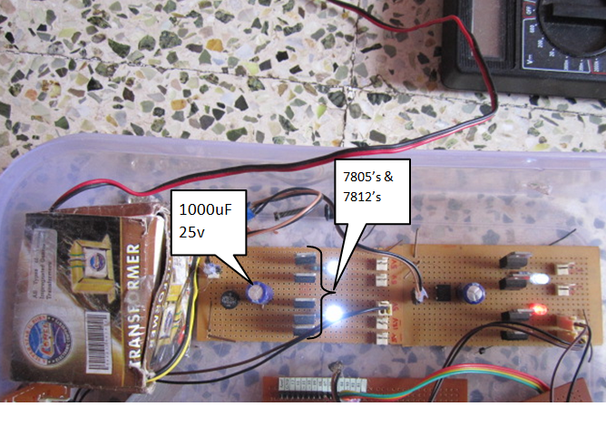

Hey guys thanks again for reply,
But for using ATXPSU only my concerns are as below.
- This is having much more ampere capacity then my requirement as you can see in above posted image, won't it blow up my sevos,dc motor and stepper drivers.
- How much (exact) load requirement will be there and one which line(5v or 12v), I tested that ATX without any load with multimeter and it gave right readings.(12.03 v and 5.12v), so is there requirement for dummy load resistor or dummy light bulb...
Thanks,
