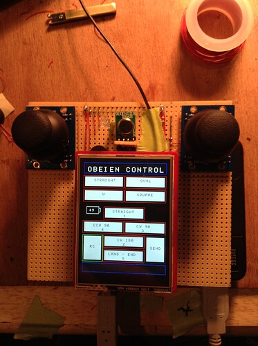

I made an RC controller for a drone airplane project. The controller sends pre-flight instructions and also has two joysticks that overrides the aircraft instructions if I need to take control. I used a 433 mhz transmitter and receiver. It works well.
Here is some test code I made while testing transmission and receiving the joystick pot values. This just reads 3 pots of the joystick and transmits it to the receiver. The receiver reads the signal and converts it back to 3 pot values that can be used to control servos. I used a Mega in the transmitter and a micro in the receiver. I hope this helps.

Here is a picture of my controller:
Dave
