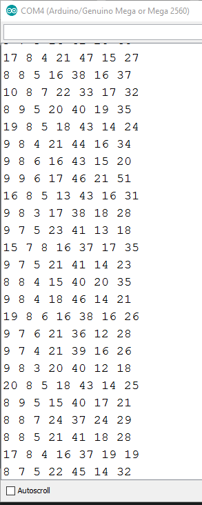

My issue consists of the MSGEQ7 simply not responding to my audio when played. Currently, my output has a bunch of random numbers in the serial monitor. So, at-least the MSGEQ7 is outputting something.
Serial Monitor:
My goal is to have this properly reacting to Audio. My thoughts are that the issues can lie with the MSGEQ7, the Audio coming in, and possibly, hopefully not, the code.

I went ahead and tried this set-up,
You said that the big one connects to the tip.
I looked up a picture that says the tip is left.
You said that the common ground is the lowest one.
I checked and saw the lower one, so that's ground.
That only leaves right left, which the picture says should be the other clip.
After trying this, it worked!
