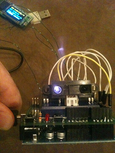

I had also ordered some Sharp IR sensors so next I plugged that in and added some code. I honestly thought that would be the hardest part but I had that working in about 10 minutes.
Here is the whole setup:

Thanks, the second go seems to have stuck it but I kept it taped anyway just in case. You're probably right though, i was trying not to damage anything. It's a very small pad.
Very Cool. On a USB port there is a ground; if it can charge via USB maybe you can use it as a common ground with transistors.
