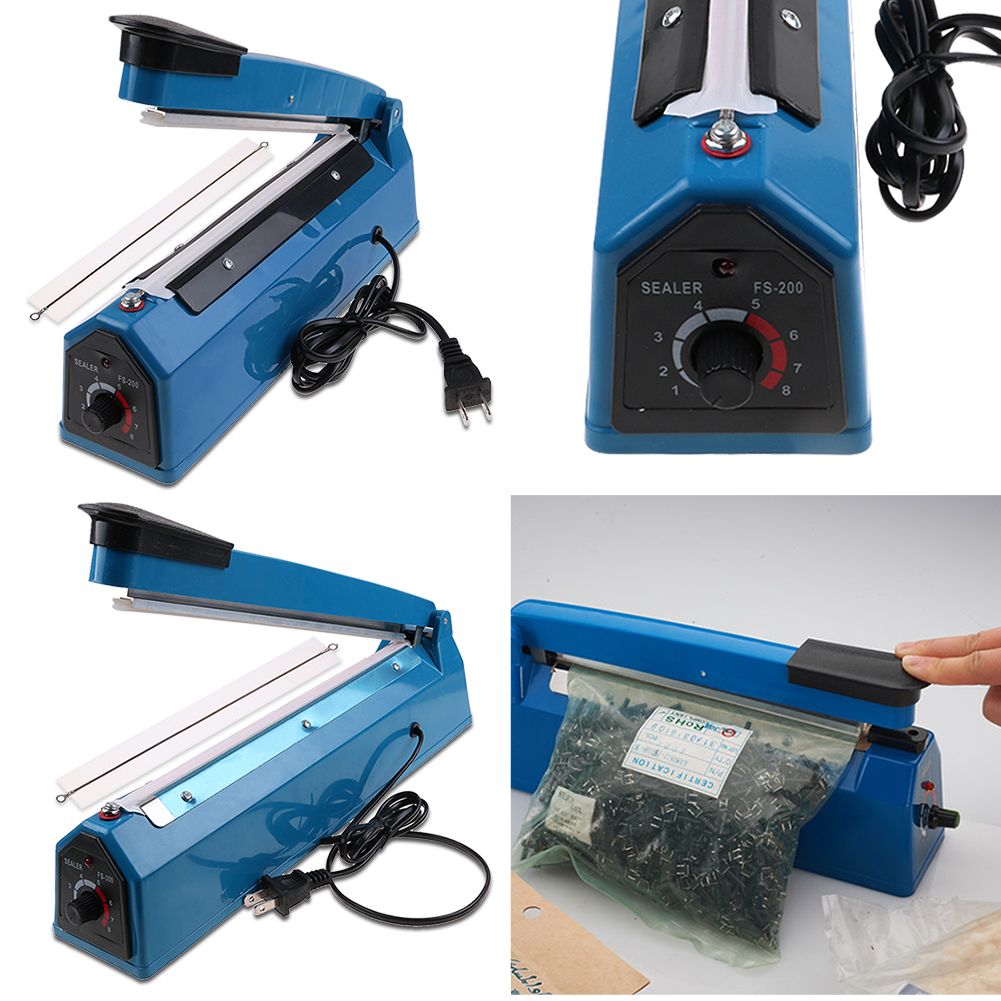

We all have a set of tools that are not being contained.
Tools can easily get misplaced, soon we have a set missing that one tool we like the best.
You can keep yourself organized by making your own 'Tool Pouch'.
If you have access to a 'Hand Impulse Heat Sealer Machine' you can design your own roll-up pouch.
These 'Sealer Machines' cost about $40-50 and come with replacement heating parts.
http://www.ebay.ca/itm/282528187573
These easily seal: 6mil poly, anti-static bags and other sheet plastics.
They can also seal that aluminumized half bag of potato chips. ;)
4 mil sheet plastic takes about 2 seconds to seal with 1-2 seconds cool down.
Below is a 4 mil ZipLoc bag, writing is removed with IPA.
Set the timer dial setting to ~3-4 (1-1.5 sec).
Use a spacer to get even compartments.
A tongue depressor is used.
