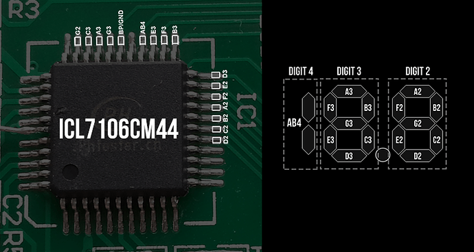

what I did:
Samba posted the chip name and datasheet, and guynaor said that LCD's drives on AC, and he was right.
After I cracked the case open, I dumped the switch and battaries and connected it to 5VDC.
Mesured the voltage that drives the LCD and it was about 4.6 VAC.
using the datasheet and some tracing with a multimeter I determined that there are 2 full digits used and a half a digit which is the 1, and of course the dot, because I don't care about the dot.
and the conclusion:
Pin BP/GND - its like the common ground for the LCD
Pin AB4 - Drives the "1" first digit
Pins A3-G3 - Drives the second letter
Pins A2-G2 - Drives the third letter (the first after the decimal)
Pins A1-G1 - Not in use (but if you want higher resolution for the pH metering you get it here) I won't be using it
its 15 pins for all segments and one ground
I soldered to each pin a wire (soldering to the LCD pads would be much easier but I wanted it on for debugging)
I took 16 Diodes (1N4001 - this is what I had) and "rectified" the currents, resulting in signals that are about 2.5-2.6 VDC peak
second part is two shift registers (CD2041BE) linked together, every shift register has 8 inputs, so its 16 total.
each input lead connected to ground with a 100K pullup resistor (I think 10K will be enough) and each signal connected to different input pin
Inputs 1-7 -> A3-G3
Input 8 -> AB4
Second chip:
Inputs 1-7 -> A2-G2
made some calculations and matched binary codes to the digits that are showing.
