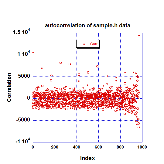

A problem with the code as posted is that the autocorrelation sum depends on the number of samples correlated, which become smaller as the index (i) increases. That is, the autocorrelation sum is not properly scaled.
I fixed that, and also eliminated the condition that the program stop as soon as it found a large peak. A plot of the results shows a number of large peaks in the autocorrelation function, so the result is less clean than the OP claims. (The plot becomes noisier toward the right end, because the number of samples included in the sum is small and the error increases).
The inner loop now looks like this (should probably divide by (k-1), but that is a minor detail)
    for (k=0; k <len-i; k++)
      sum += (rawData[k]) * (rawData[k+i]);
    sum /= k ;
    fprintf(fp,"%ld\n",sum);
Note: normally the average value of the data points is subtracted from each term, but here, the average is not large (-4).
@jremington
can you post your complete version?
See below. This simplified version is for Code::Blocks on a PC, because I wanted to write out a file of the results for plotting and inspection.
Note: another problem with the original code is that the peak detect algorithm detects only the first peak (not necessarily the largest). I did not bother to fix that.

Just for completeness, I calculated the Fourier transform (as an FFT of length 1024, zero padded) on the original data, and the output is shown on the attached plot.
As you can see, the autocorrelation function does quite a bit better than the FFT to distinguish the frequency of interest, but there are other peaks in the autocorrelation function nearly as large, so it would be difficult to have much confidence in the result.
I think you may have a problem with your code. You have defined rawData to be an array of type char. When you perform the multiplication in the step which multiplies the two rawData values you are overflowing the type char. The multiplication is done on type char before it is assigned to variable sum.
I have been bitten by this before. Try casting rawData to long before doing the multiplication and see if you get the same answer.

Curiously, using Code::Blocks/gcc on the PC as I was, it does not make any difference to the overall result to cast rawData[] as long, i.e. sum += ( (long) rawData[k]) * ( (long) rawData[k+i]);
It appears that on the PC, Code::Blocks promotes the type char to a larger integer for the purpose of the multiplication. I haven't yet figured out how to view the machine code listing to check this supposition, so I printed out the first few values of rawData[]*rawData[] using the following statement:    fprintf(fp,"%d,%d,%d\n",i,rawData[i],rawData[i]*rawData[i]);and got the following values:
0,115,13225
1,126,15876
2,62,3844
3,57,3249
4,-80,6400
5,77,5929
Clearly, the multiplication is not overflowing the char data type. So, I don't see why Matlab would give a "much different result" for the autocorrelation function (why not show us what it is?).
I checked the operations performed by Matlab and found that the built-in function autocorr() calculates the same unweighted function that the OP originally described (except that the mean value of the data is properly subtracted). This is fine for short lags but reduces the weight of peaks associated with large lags. From the autocorr help message "the form adopted here follows that of Box, Jenkins, and Reinsel ... Time Series Analysis: Forecasting and Control. 3rd ed. Upper Saddle River, NJ: Prentice-Hall, 1994". I've attached a sample plot obtained by using the following Matlab script:
m=csvread('test.txt');
ACF=autocorr(m(:,2),969);
plot(ACF);
One can see how the peaks diminish as the lag increases, which I consider to be misleading. The Fourier transform of this particular autocorrelation function will not be the same as the power spectrum plot of the zero-filled FFT that I posted earlier.
