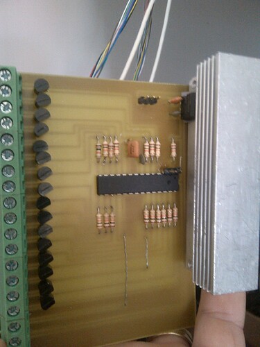

Hi all,
I am new in the field of programming, i have 16 stairs at my home, this code is working perfect for me but every time on side (bottom or top ) is triggered the system i waiting for an other triggering to shut down the LED's. Now i want tho change (add) something in the code that after one triggering (LED's ON) from any side to shut them off automatically after certain time. (not to wait for triggering again)
The code is in attachment.
THX in advance

Edmond:
Because you are using delay() between each light working and because you are not using an array yo store all the LED pin numbers it may mean a major rewrite of your code.
The alternative to using delay() for the timing is the technique in the Blink Without Delay example sketch. This is n extended demo of the technique several things at a time.
In principle, you need to record the value of millis() when the start button is pressed and then periodicaly check if the newest value of miilis() exceeds that saved value by whatever interval you choose.
startMillis = millis();
// and later
if (millis() - startMillis > interval) {
   // switch off LEDS
The problem is where to put the IF clause so that it gets checked regularly - you can see how it is done in several things
If you use an array to store the LED pins you can reduce your whole code to a few lines.
...R
This code is what i managed to modify from an other code what i found on the web (link to original code: Monkfish's LED Stair Lights (proof of concept) - Pastebin.com) i just added the other 7 led pins to the code. i am using 12V LED strips controlled by transistors. I have god knowledge of electronics but like i said before, just a few stuff in programming. Sow the thing with array for the pins no clue about.
The code is working fine. in stead of buttons i use ir crossbeam detector placed on the first and last step. when i walk up the stairs the lights are going on one by one with 250millis between the steps and when i reach the last step the lights ar going off with 700millis between the steps (And the same thing going down), That is OK, what i want is that after the first triggering form any direction, even if i don't cross any of the detector's, after a certain time the led's should go off. (fro example after 20 seconds)
Anyhow thx allot for your reply.
You will find that your code gets simpler and easier to read and maintain if you persevere with learning about how to use arrays.
You'll almost certainly need to get rid of all the calls to delay().
Attached are some pictures of the finished functional board.
For the moment i am learning c++, in the future for shore this stuff will be something easy for me but right now it is unknown Territory, I really need help with this project.
