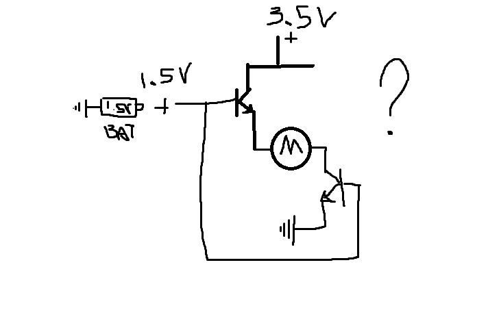

the led or the load has no problem switching if its in the collectors pin but
when the led is in the emitter, the led will not light. no switching is done.
as well as the hbridge. it seems impossible to make it work. whats wrong with it? connections of pins are correct.
Double check your wiring, and make sure only one side of the H bridge is on at a time.
HazardsMind:
this half of the hbridge didnt also work. as the first transistor doesn't triggered since the load is in the emitter.
I don't think 3.5 volts is enough to drive that circuit. Try 6 or 9 volts, and 5v at the base.
That circuit will not work as it stands and may damage the lower transistor because there is no resistor to limit the base current. Put a 100 ohm resistor in series with the base of the upper transistor, and a 470 ohm resistor in series with the base of the lower transistor. Increase both the power supply voltage and the drive voltage to 5V. That will give you about 3V or 3.5V across the load.

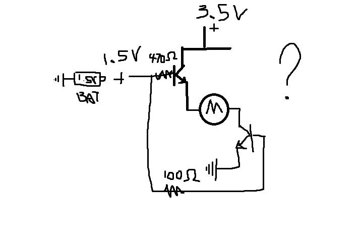

dc42:
is this what your trying to express?
The resistors go the other way round (470 ohm to the lower transistor, 100 ohm to the upper transistor), and both the 1.5V and the 3.5V need to be increased to 5V if you want to feed about 3.5V to the motor.
Yes but swap the resistors around, and provide 5volts (not 1.5v) to the base and 6-9volts(not 3.5v) to the actual power source.
Edit: dc42 beat me to it.
dc42:
thanks for the help, but my problem is in the robots motor. it only has lower than 4v i think for its dc motor, and i want to amplify it to a bigger volts. and replacing its motor to a bigger motor,. 6v motor.
