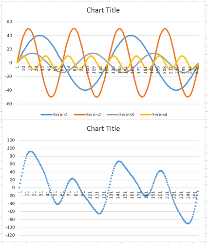

I have modified the code somewhat customizing the wave forms and envelopes.

So the length of the note is looked up in a table.. this is how long the 127 steps of amplification take.
The envelopes included are basic. I use a spread sheet to create envelopes and waves.
Another modification I have made is to increase to 6 notes, reducing the amplitude, and reduced the note step frequency by 1/2, and doubled the wave form. This is so the base frequency will repeat 2 times in 256 bytes. This allows for the 3rd harmonic to be included, but reduces accuracy.
I attached a image of a waveform with this double cycle.
Cheers, Richard
