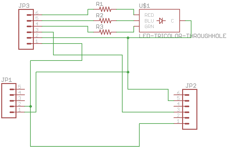

I am having an issue with code not starting when the chip is powered up. I am using a stand alone ATMEGA328 (programmed with the arduino ide and with the arduino bootloader). I have successfully run code on this chip (in the exact same circuit) without any issues. Here is the code that has a delay (about 1-2 minutes) before the program gets to the main loop:

I have uploaded this code onto the ATMEGA328 and given it power. But it takes about 1-2 minutes for the program to reach the main loop. I think that this is the case because the first thing in the main loop is to turn pin 12 to HIGH. It take about 1-2 minutes (from when the power is switched on) for pin 12 to go high. I think that this is a problem with the code because I have been able to run code (that only turned on pin 12, that's it) and it worked fine. The circuit is in two parts (one part goes indoors and the other goes outdoors) and is on a pcb. Basically this is a rfid door lock system that sends information to a computer via an xbee network. I have attached images of the indoor and outdoor schematics as well. Anyway the real problem is that the program takes about 1-2 minutes to get into the main loop (At least it appears that way). Any help is greatly appreciated.

Is that really a 10 millifarad capacitor on the VCC line? 10000 microfarads?
12150w
I presume the cct you supplied is all the components.?
You don't seem to have included any High frequency bypass capacitors.
Digital electronics (esp TTL devices) need a 0.1uF capacitor across every IC, to stop high frequency spikes upsetting other devices.
The larger capacitors are good at smoothing out larger voltage flucuations, but they are uesless at the fast high frequency spikes.
I would include one acoss pin 7 and 22 (the supply pins) of the 328, the +5v and gnd of the xbee, and both of the 10uF caps on your regulator.
its also good practice to include caps across the supply to other boards, or the incoming supply.
Good luck
Mark
Wow those are all great suggestions. I will add debugging flashes the next chance that I get. Also the capacitor you speak of (Nick Gammon) is a 10 microfarad. I didn't know exactly how to type in the character "µ" into eagle at the time. Also I had never thought about bypass capacitors (in fact I just figured out what they were). I will add those to the 328, xbee (it is on the xbee adapter from adafruit though), and on both ends of the wires to the outside board. The final length of the wire that connects the two boards will probably be about 5 feet and will need the capacitors for sure. Also I will include them on the rfid reader on the outside board (it is shown as 2 headers on the schematic but is really the id-20 rfid reader). Hopefully that will clear up some of my problems. I will try it out and reply as soon as possible about how well it works.

It very well could be and it may not be receiving these because of the circuit. But I turned on the lock (it is a fail safe lock) before I called scan_card(). It still had the delay. I will try skipping that function to see if it gets rid of the delay. But the more I think about it I am sure it is the circuit. I noticed that while it is in the delay the rgb led is blue and the correct brightness. But after the delay, when the lock turns on, the led goes to red (which it is supposed to) but the brightness is considerably lower.
Well I added bypass capacitors to both the indoor and outdoor circuits (except the xbee because there is already one on the adapter I am using). Unfortunately it did not stop the delay but I have a hunch that it makes the circuit run better. For one thing the regulator isn't getting as hot. I need to try the debugging flashes still but have not found the time. I should be able to to it within the next few days however as time permits. Anyway thanks for the suggestion (about the bypass capacitors) I certainly learned something new that I didn't know before (I did some more research on bypass capacitors). I will try the debugging flashes and see how that goes soon.
