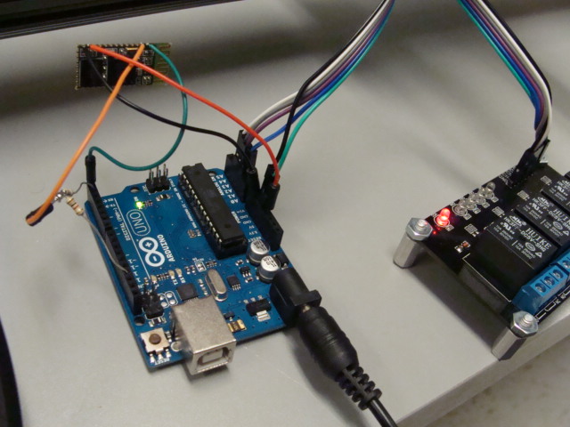

Today I discovered that there is a circuit error on the Motomama board in that the XBee socket is getting 5V instead of 3.3V. This means that I have been trying to run the HC-05 circuit on 5V. I can still connect to it, but the data is always garbage. Do you think 5V damaged the HC-05 beyond repair? To recover, I ordered some bare HC-05 modules and I will connect them manually to the Arduino, using its 3.3V supply. I will make sure to voltage divide for the Rx pin.

Hi Nick,
Yes, I did buy the basic HC-05 modules (5 for $11 off eBay). I bought them just to experiment with. Of course, they have no LEDs and you need to create a simple resistor divider to use it properly, but you can get away with the default settings and prove that it all works. I soldered Tx, Rx, VCC and GND leads and connected them to Arduino. I had to make one resistor divider for Rx. The main thing is is that I got it to work. This method is too fragile for my needs, so I will look at either the JY-MCU boards you talk about ($7.90 at dx.com with free shipping) or simpler BTBee from iteadstudio. I ordered two of them already. They would be a cleaner implementation because the Motomama motor driver board has an XBEE socket on it. Attached is a picture of the UNO with the HC-05 hanging off it with a 5V relay board attached to the analog pins. I was controlling the relays from my Android phone yesterday.

Hi
That looks like quite a triumph in itself. I took the easy way out and bought the boards. They cost $3.14 each.
Soldering them up was not as hard as I thought. I sharpened the bit on the iron but I'm not sure it was necessary. Note that HC-05 and HC-06 have different connections for the LED. I soldered mine the wrong way but I have not bothered to fix it.
