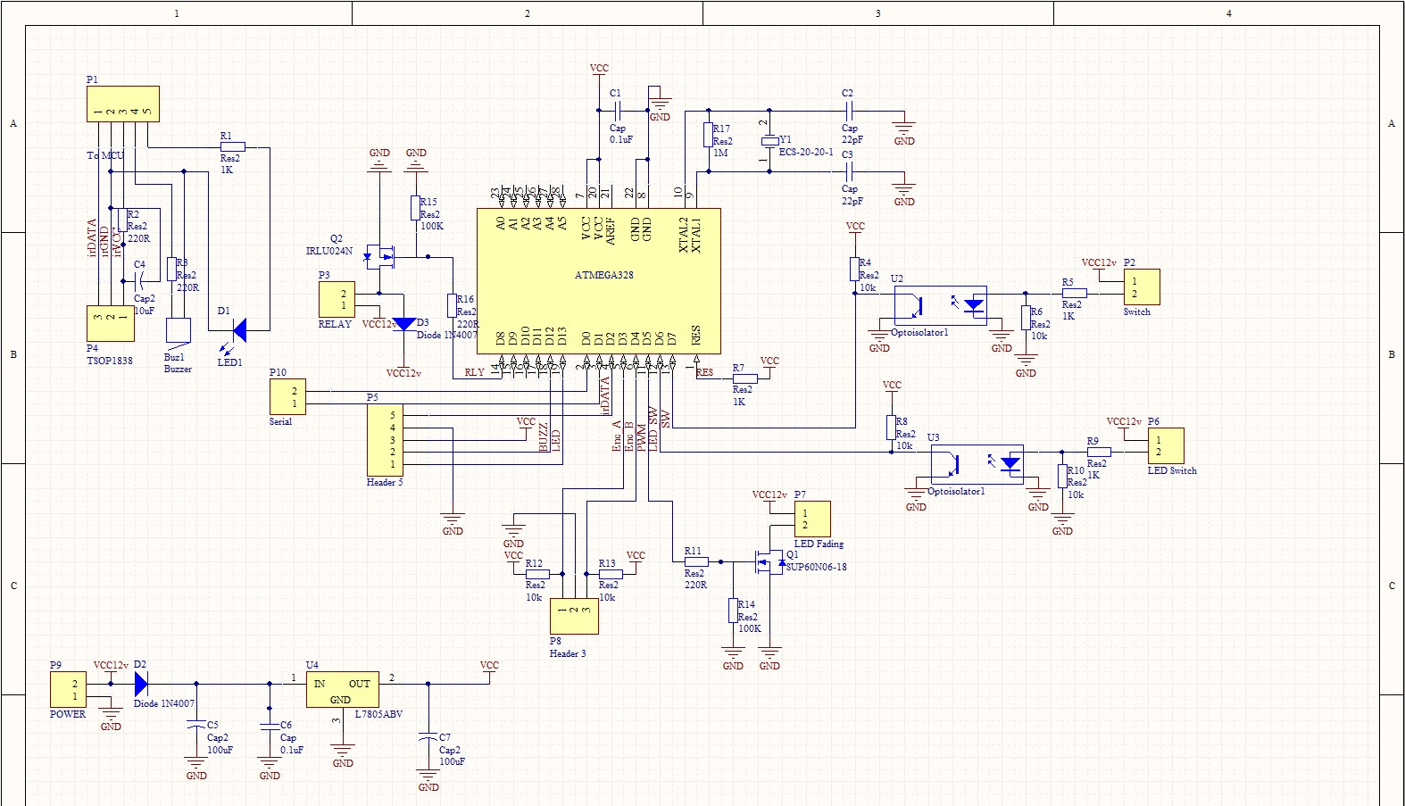

I'm sorry for mistakes in schematic... I've corrected them to represent the real world situation, it was only on the paper. Ok, I will try some bigger decoupling cap, and see how it goes. As for pullup on irDATA line from TSOP1840 IR detector - it already has 100k internal pull up, plus arduino 20k plus extra 100k makes around 14k summary resistance, so I doubt the problem is pullups. When the glitch happen, I checked power with osciloscoope and it was clean and steady, so PSU is not the issue either. The main problem is I can't replicate the thing... it just comes and goes without any external factor, what makes the debugging a real nightmare. Anyway, here is the code (Yes, I know its a bit mess, and will be hard to understand since my comments are mainly in Latvian)...
