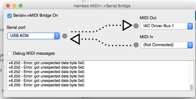

I'm getting errors on MIDI Hairless.
Serial.begin(9600)
Use the same baud rate as Hairless is set to.
MIDI is concerned with discrete note on, note off events. Is that what you want to do?
Or do you want a continuous note who's pitch depends on the output from the sensor?
Hey THanks for the reply.
I've since changed them so they are both 9600 and it seems to still be giving me the same error.

Okay so tried a few things. First I tried change the baud rate to 115200 on mid hairless and in the code. I noticed after I did that I wasn't receiving packets anymore. The LEDs I have hooked stopped reacting to the data.
So I changed it back to 9600. I then removed the
Serial.println(brain.readCSV());
Which didnt give me and midi data.
I then tried to remove the
 if (brain.readSignalQuality() == 0)
And that allowed me to midi map a slider. But it just kept going from 0-100 in one second intervals and my LEDs were not working.

You can't use the hardware UART for the brain sensor and for MIDI at the same time.
Either use SoftwareSerial for the brain, or get an Arduino that has more than one hardware UART, or one hardware UART and USB.
If you get a board like the Leonardo, you can use USB MIDI (much easier than Hairless), and the hardware UART can be used by the brain sensor.
Pieter

With an UNO, you can NOT send MIDI and other data to the computer at the same time, especially if you have something connected to pins 0 and 1.
What brain libiary are you using. I have had a look and found two on the first three returns from google.
I am concerned about the line:-
Brain brain(Serial)
It implies that your brain sensor is communicating with the Arduino through the serial port. How is your sensor connected? If it is to pins 0 & 1 then you can not send MIDI data over the USB and send it to hairless as well as talking to the brain sensor. It is also likely that the brain software is changing the hardware baud rate.

The library does indeed use the Serial port. That's why I recommended using SoftwareSerial.
PieterP:
I've taken your advice and ordered an Arduino Leonardo
