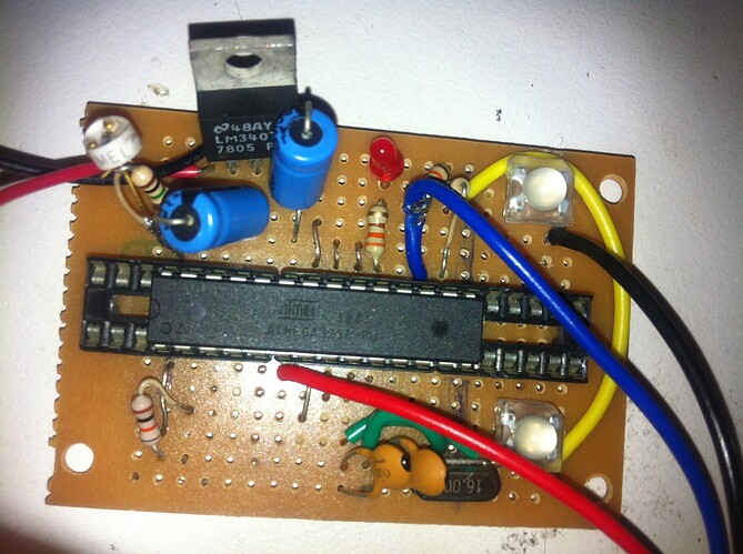

ive made my own board using the atmega. im using an 7805 as a voltage regulator. is that good enough? there is no power led or any other superflous hardware (i think.) i have read about using the internal clock so as to do away with the crystal, that would be something to consider if i could find a nice easy step by step guide where i dont need to buy any extra programmers and dont have the option to brick my chip.
ive attached pictures. the PIR is powered off a digital pin (pirOnPin) and is only activated when a light threshold is reached.

anyone know if the 7805 voltage regulator is low-leak like Drmn4ea was suggesting?
also the Nightingale sketch doesnt have a voltage regulator. do i even need one??
will there be an harm in running straight off the battery? i was planning on using a 9v down to 5v through 7805, but if i can run off 4x1.2v AA...

  2. The standard 7805 has a quiescent current of about 5mA, so far too high for your application. You need something like LM2396-5.0 instead (9uA typical quiescent current when the load current is <100uA).
The capacity of a 9v battery is around 565mAH for alkaline and 1.2Ah for lithium. So you'll need to get the average current consumption (including PIR) down to 45uA for a lithium 9v battery to last 3 years.
