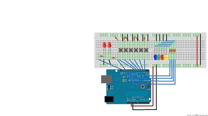

Hello,
I'm trying to make a controller that records a switch press sequence on four switches and plays them back when triggered. I have went through several examples and tutorials trying to make this work and thought I had it down but when I upload and try and run the sketch it doesn't seem to work (I bet we are all very familiar with that :astonished:) I have been attempting to debug it for hours and cant seem to nail down how to fix the problem, though I think I know about where it is.
Project background:
There are 4 switches which are recorded, one for trigger, and one for record connected on pins 2-7. The switches are momentary NO tactile push-buttons. The LED's that indicate when a output is high are on 8-11, the record indicator light is on 12 and play indicator is on 13. When the record switch is pressed and released the arduino (duemilanove 328) records the sequence of the 4 programming switches storing the times they are pressed as well in a 2d array. When the trigger is pressed it plays back the switch sequence. All of the switches are on pullup resistors and wait for a LOW signal.
I have included the whole sketch below and have tried to comment it such that it is easy to follow.

I am not the best programmer so the code may not be very efficient and it might not follow proper code etiquette, but the problem seems to be in the playShow and recordShow functions and I may have not debounced properly because commenting the body's of the two if statements in the main loop and adding a command to send "test" to the serial monitor instead works. I modeled the debounce after the adafruit tutorial. I'm sure the mistake is elementary and noobish but appreciate any help anyone could give. I'm kinda at a brick wall on how to fix this.
unsigned long  show_seq[300][3];
300 * 3 * 4= ?
Which processor are you using?
the 328
So, of your 2048 bytes of RAM, you've reserved 3600 for this one array.
Ok, I changed that to a 100 element array. I'm an idiot, variables are stored in the RAM not flash, duh :blush:. But it still doesn't work.
Your code is very hard to follow, but when you get to writing stuff like the b4val = digitalRead(but4); and
int but1 = 2;
int but2 = 3;
int but3 = 4;
int but4 = 5;
int out1 = 8;
int out2 = 9;
int out3 = 10;
int out4 = 11;
repeatedly nearly always suggests that you should be using arrays for similar constructs.
Shorter code makes it easier to read, and gives the bugs fewer dark corners to hide in.
For the switches, you are not enabling the internal pull-up resistors, which suggests that you (should) have external pull-up or pull-down resistors. Do you?

Why would you want to wait for up to 10 milliseconds after the button is released to notice it?
There is a nice library that handles de-bouncing buttons. Why not use that library?
Ok, I cleaned it up with for loops. However it is still stuck in the record function only iterating the while loop once. Also once you press the buttons that turn on the outputs they only light up once. I think its where I'm trying to implement the debounce. I've been trying to sort this out all day and have had no luck. I hope its easier to follow now. Here's the code:

Attached is the board setup (as good as I could draw it in Fritzing)
